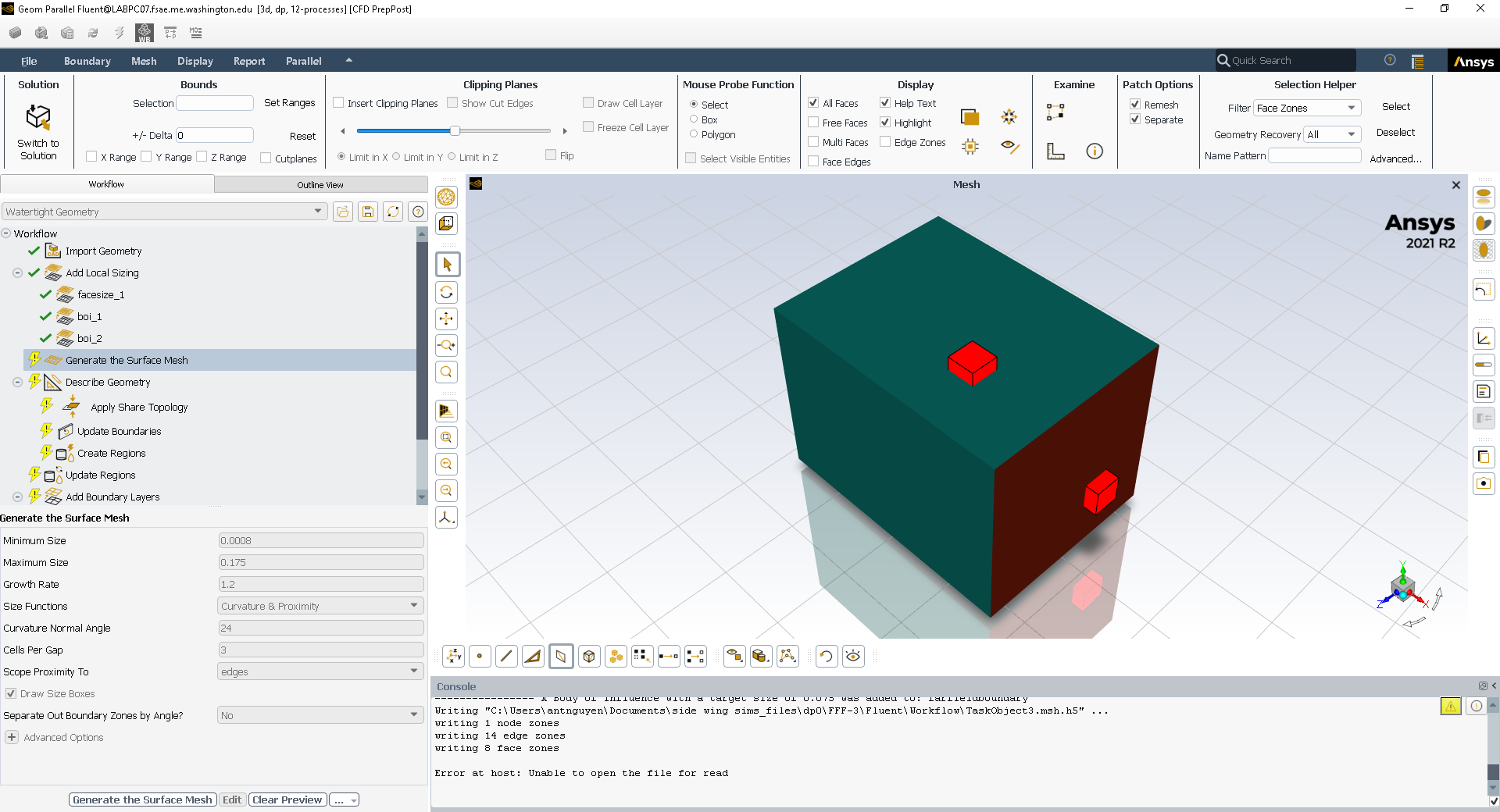

SubscriberI am fairly new to CFD and I am trying to make a mesh for some 3D wings however I am running to an issue where the mesher is giving me an "Error at host: Unable to open the file for read" and is stuck on generating the surface mesh. What is happening and how can I prevent this from happening in the future?
November 3, 2021 at 11:24 amRob
Forum ModeratorAssuming there are no "odd" characters in the UserID can you re-try with a path that doesn't contain spaces? The workflow runs a script in the background and may see the spaces as something else.
May 19, 2022 at 10:15 amJCJ
SubscriberHey, I m facing the same issue while using Fluent 2021 R2. As suggested there are no odd characters or spaces in the userID and path. could you help.
May 19, 2022 at 10:19 amRob
Forum ModeratorAre you working with any OneDrive linked folders or a mapped network drive?
