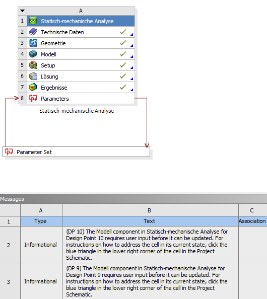

      i tried to simulate different Design Points/making a parameter correlation in my workbench, but the geometry didn't change.
      I parameterized my model trough the script-tool with spaceclaim. When i change the parameter manualy i got no issues with the model, and i dont get a error message when i use the update all design points button->just get the message that my "model" in the static structural calculation needs a userinput information. When i go into the static structural model everything got the green check-marker.

      If you can solve it manually, it can be due to temparory loss of license or other similar issues.
      After update all, if there are any unsolved designpoints, right click on them set as current and update selected designpoint. Does that work?

      i can solve them manualy, also it worked for the Design Point i updated like you described.

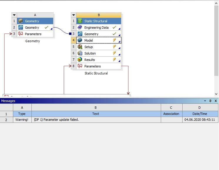

      Solved this by checking on the material settings of the model. Set Material settings in the Static Structural Model.
    • konahowler
      But now I got a new Warning Message: (DP1) Parameter update failed. When I try to run several DesignPoints the Geometry isn't updated for each model. When I change the Paraemters in SpaceClaim this is not a Problem, also it is possible to change the parameters in the Parameters section of workbench trough SpaceClaim.
      this connection between Workbench and SpaceClaim is working

      Hey sorry, it was marked as solved so I didn't see this earlier than this
      Can you please open a new thread and paste the link here. there Paste a few snaps of how your parameters are defined in SpaceClaim.
      As far as possible, use parameters based on a ruler, which is from a fixed point in the model, can be a coordinate system, plane etc.
      It is bit difficult from the looks of your model (also the language barrier, sorry about that!) but a way would be setting up a very simple case of this model while adding up parameters one after another.
      -Aniket
      You can also make use of details tab for creating measurement based dimension for planar dimensions/
