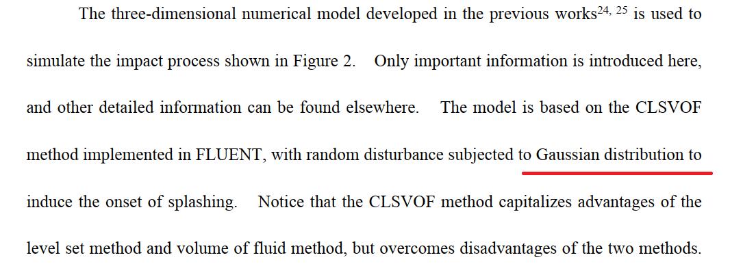

      How can i set gaussian distribution in fluent?(image)

      In which context? Disturbance of the free surface?

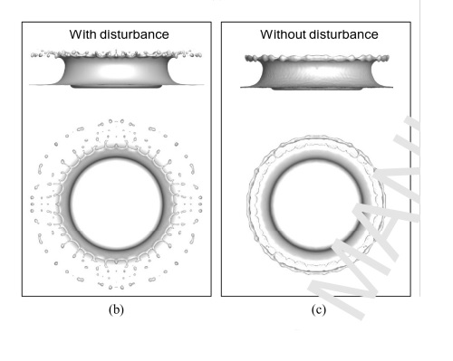

      i simulate drop impact to film flow
    • Amine Ben Hadj Ali
      Yes that is nice! So you need the disturbance on the free surface?

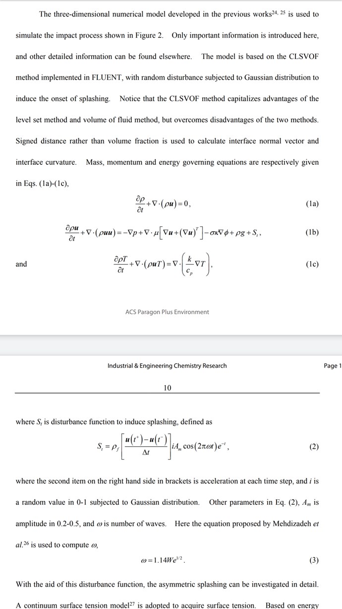

      this is my formula:
      how can write this equation in DEFINE_INIT
      where should i add this udf
