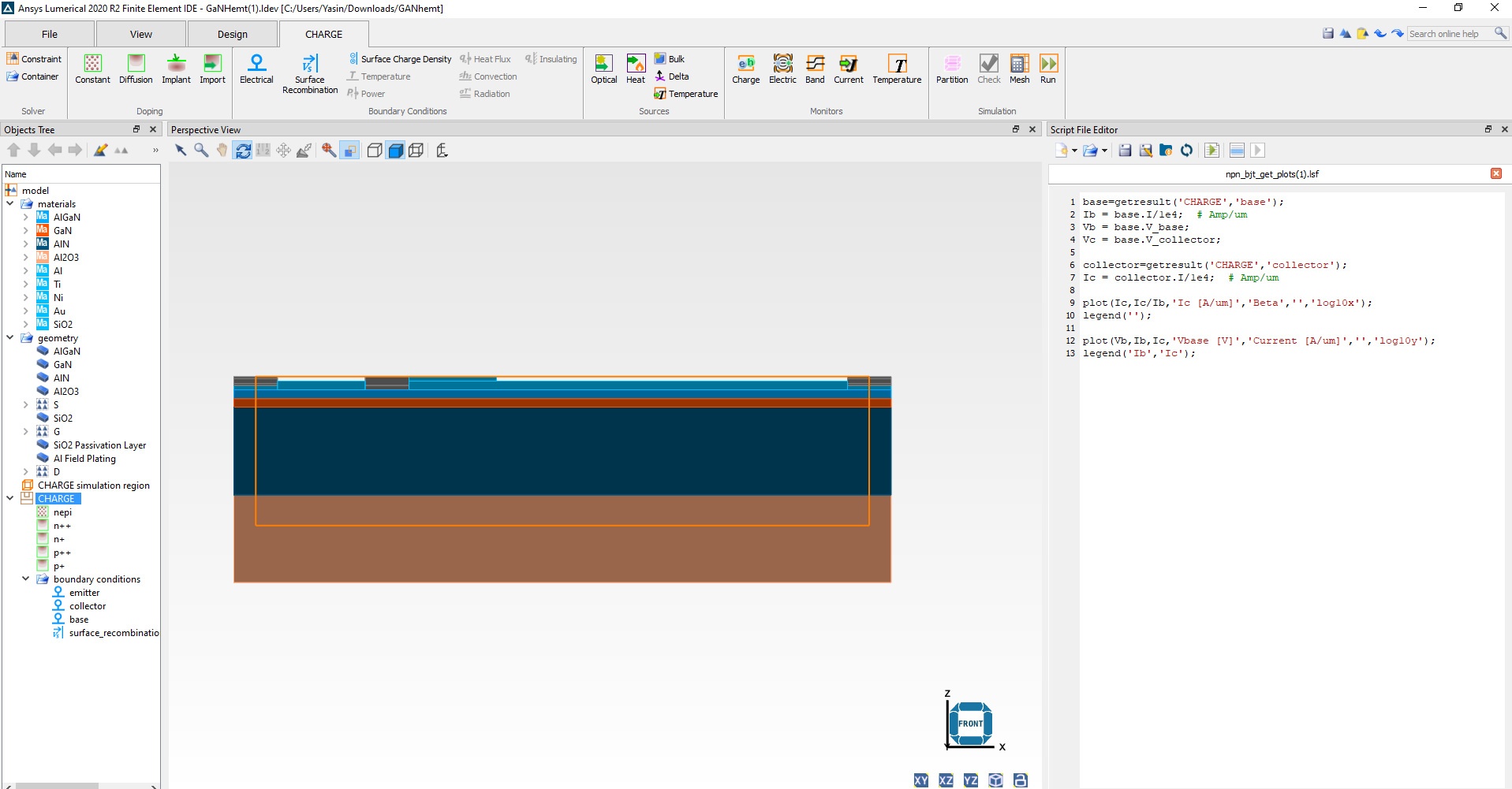

Subscriberi create this project but its not run

Subscriber─░ dont run this project can you help me ?

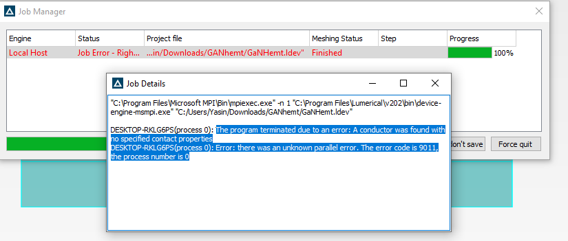

Ansys EmployeeHi Thank you for reaching out. This is related to product CHARGE. As indicated in the error message you seem to have a conductor material in your simulation without it being used a contact boundary condition. This will prevent the simulation from being run as conductors are simulated in CHARGE only as voltage boundaries.

SubscriberHow can i solve it change CHARGE Simulation Region ?or Elements privates change ....
January 10, 2022 at 6:48 amJanuary 10, 2022 at 8:32 pmkghaffari
Ansys EmployeeHi To fix this you need to make sure any objects made of conductor materials are assigned as a contact in your boundary condition; you would have go to your boundary condition settings and assign them to the metal objects.
