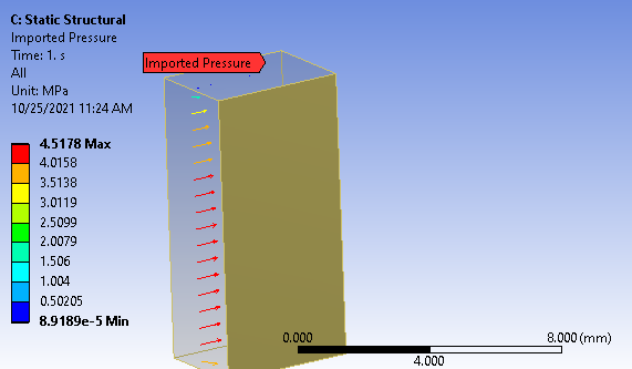

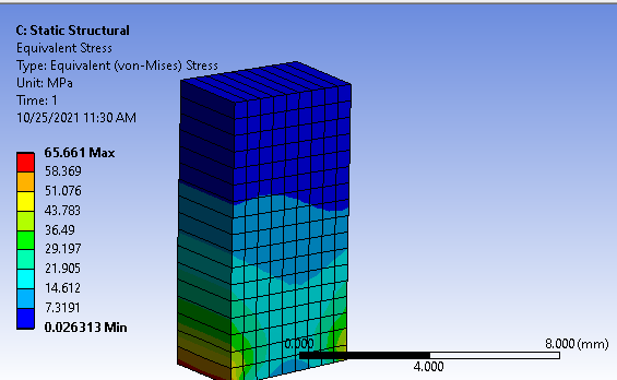

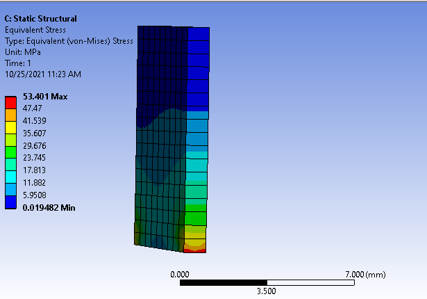

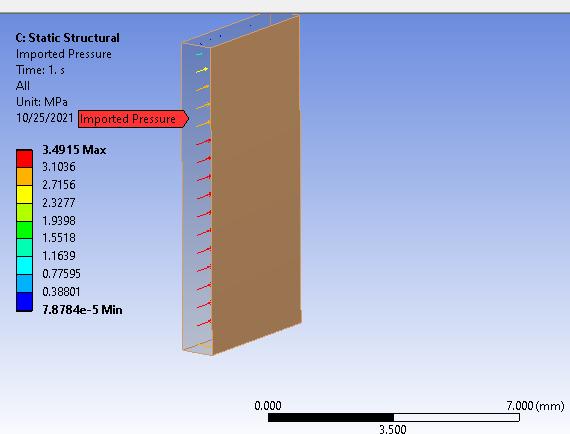

October 22, 2021 at 6:31 pmali_i_96
This is an example of what i have faced, these two simulation the first is with a 1 mm thickness and the second with 3 mm thickness. The Imported pressure differ between the two thickness , also the shear stress at walls in the Fluent results.
you can see the difference in the Equiv Stress Results with varying the thickness.
Thank you in Advance
October 23, 2021 at 4:50 pmAnanth Narayan
SubscriberDid the side face in your model contain one element in both cases?. Means- you need to set element size to 3mm in the second case because this will not form some kind of similarity I believe. Try doing this and share your results.
