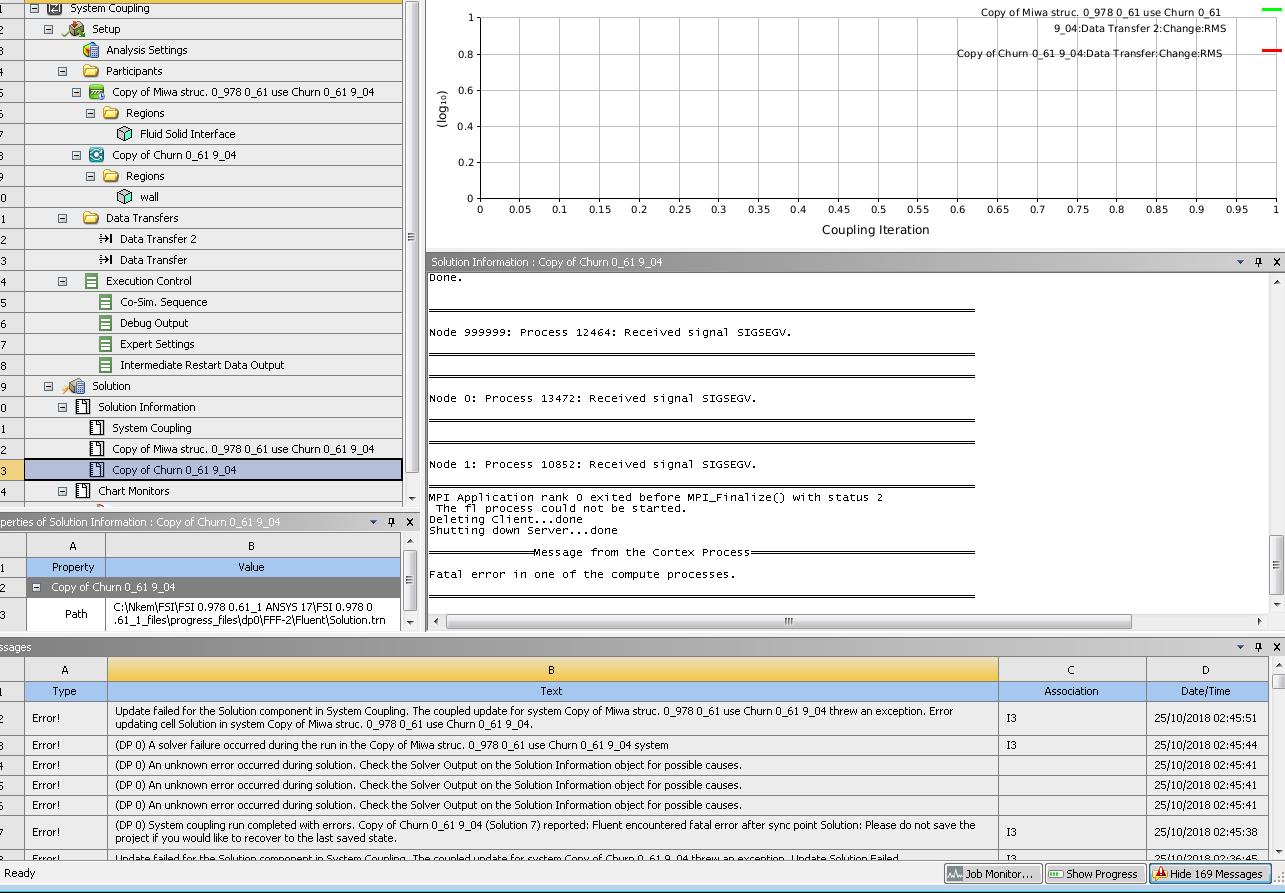

    • Nk_ad
      I don't really know what you mean by design points but I used ICEM to mesh the fluid system (see attached image ANSYS 18_1) and the simulation is in ANSYS 18.1. ANSYS 18_1
      On the other hand, running the same simulation with Fluent mesh and in ANSYS 17.0 gives the error in the 2 attached images below.
      ANSYS 17_1
      ANSYS 17_2
      All the systems run successfully individually. They only fail when I couple them.
      I could attach the workbench files of the project if you would like to see it.
      Thanks for your kind responses
      Regards
      Nkem
    • Keyur Kanade
      Can you please check if you have any spaces or special characters in your file name or folder/subfolder names. If so, can you please rename them.
      Can you please use latest version R19.2.
      Also please use workbench meshing as shown in video.
      Keyur
