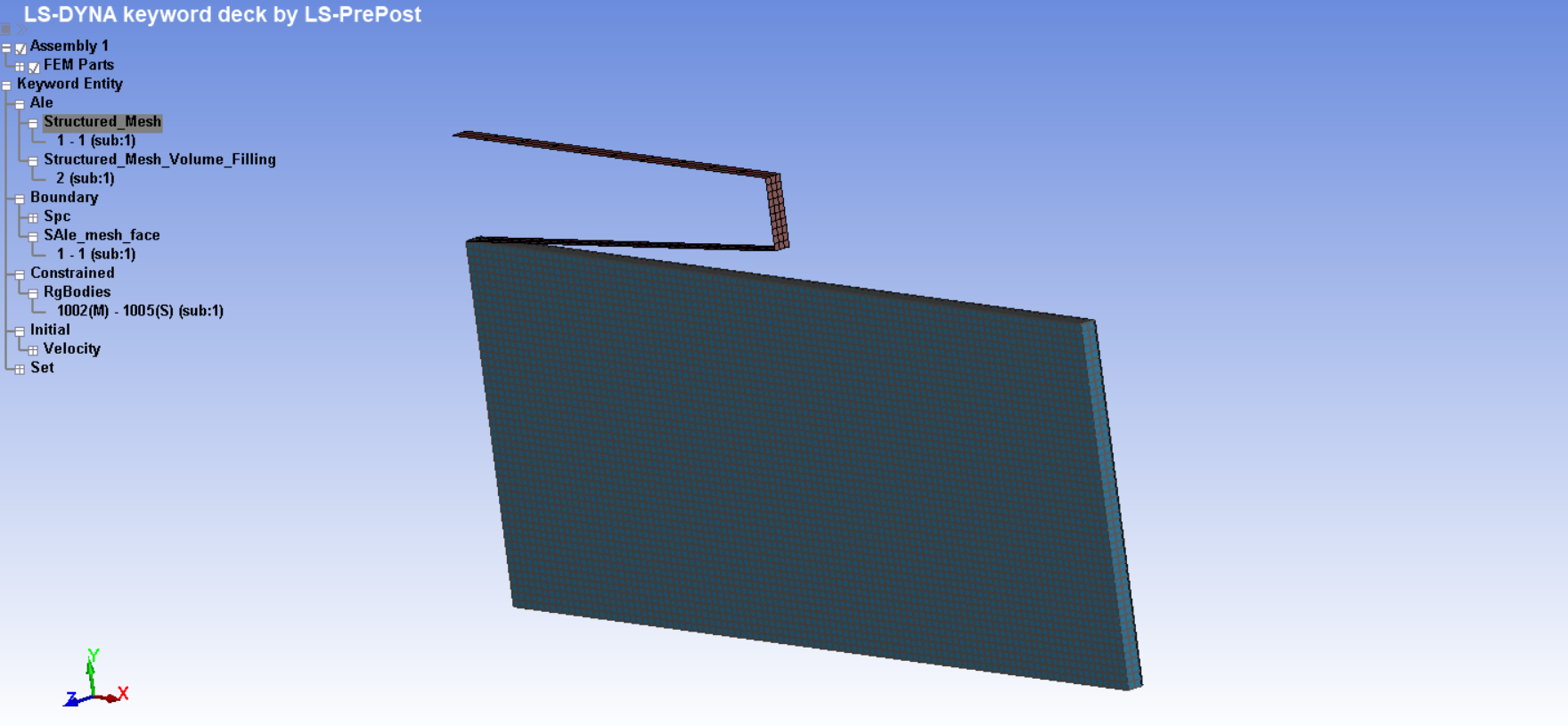

Hi
I would have a whole block s-ale domain for the air that also covers the water and air on top of water, and then a separate s-ale fill part for water (H20 – below) – see sketch.
(the below approach is ok and used can be used in most cases if we look at s-ale – I see you do not represent background air)
Perhaps others can help here,
All the bestÂ
