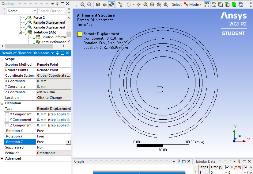

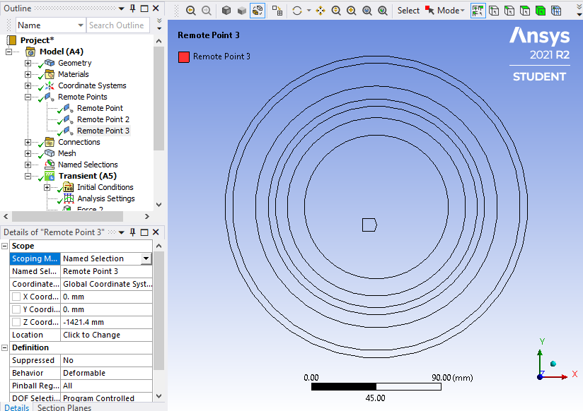

SubscriberIve a shaft whose two ends are hinged by remote disp;acement, why the shaft rotate when I apply a force on its axis???!!!
Project archive file is attached. an image of the shaft is also attached

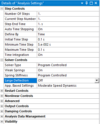

I don't understand why you chose Transient Structural. Wouldn't a Static Structural analysis give you the shaft deflection from this load that you are looking for?
Why did you turn off Large Deflection?
Small rotations cause apparently large deformation, which are not real. If you don't have any rotation in the solution, then you can leave Large Deflection Off.

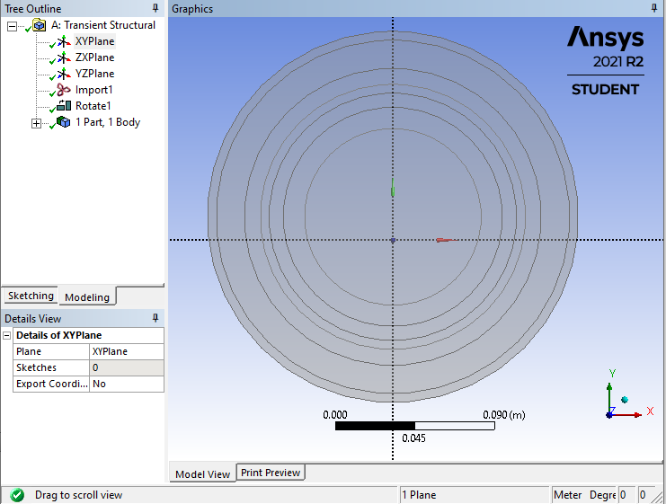

The shaft axis is offset from the global axes in CAD. In this type of model, it is convenient to put the shaft axis on the a global axis.
And the remote points are on the global axis, so they are also offset from the shaft axis.

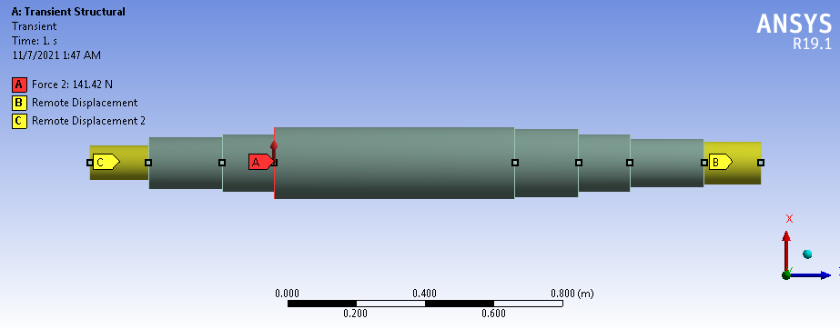

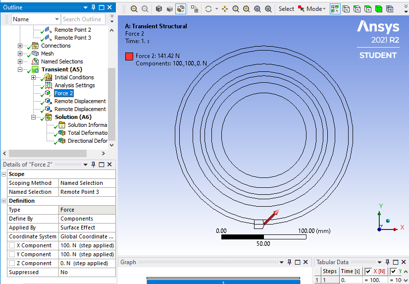

A force is applied to that the remote point above. Pay no attention to the location of the arrow on the display below, the force goes through the center of Remote Point 3. Why are you applying 100 N in each of X and Y? That makes it difficult to view the results, where the maximum plane of bending is now 45 degrees away from a global plane. I suggest applying 141.4 N in just X and leave Y at 0.
Two Remote Displacements only constrain X, Y and Z, but do not prevent rotation. This would prevent a Static Structural analysis from solving, which is perhaps why you are solving as a Transient Structural.
Since rotation is unconstrained in this solution numerical round-off errors can cause the shaft to rotate. Change one or both of the Remote Displacements to have Rotation Z = 0, then you can solve this as a Static Structural analysis.

SubscriberHi, Thank you so much for your reply, I want to model unbalance response, considering nonlinear effects, so Ive to conduct transient analysis. with regard to the offset you said, I select the x, y coordinates of the romote points so that there no moment anyway, the problem wouldnt solve, untill I draw the same geometry in ANSYS.
