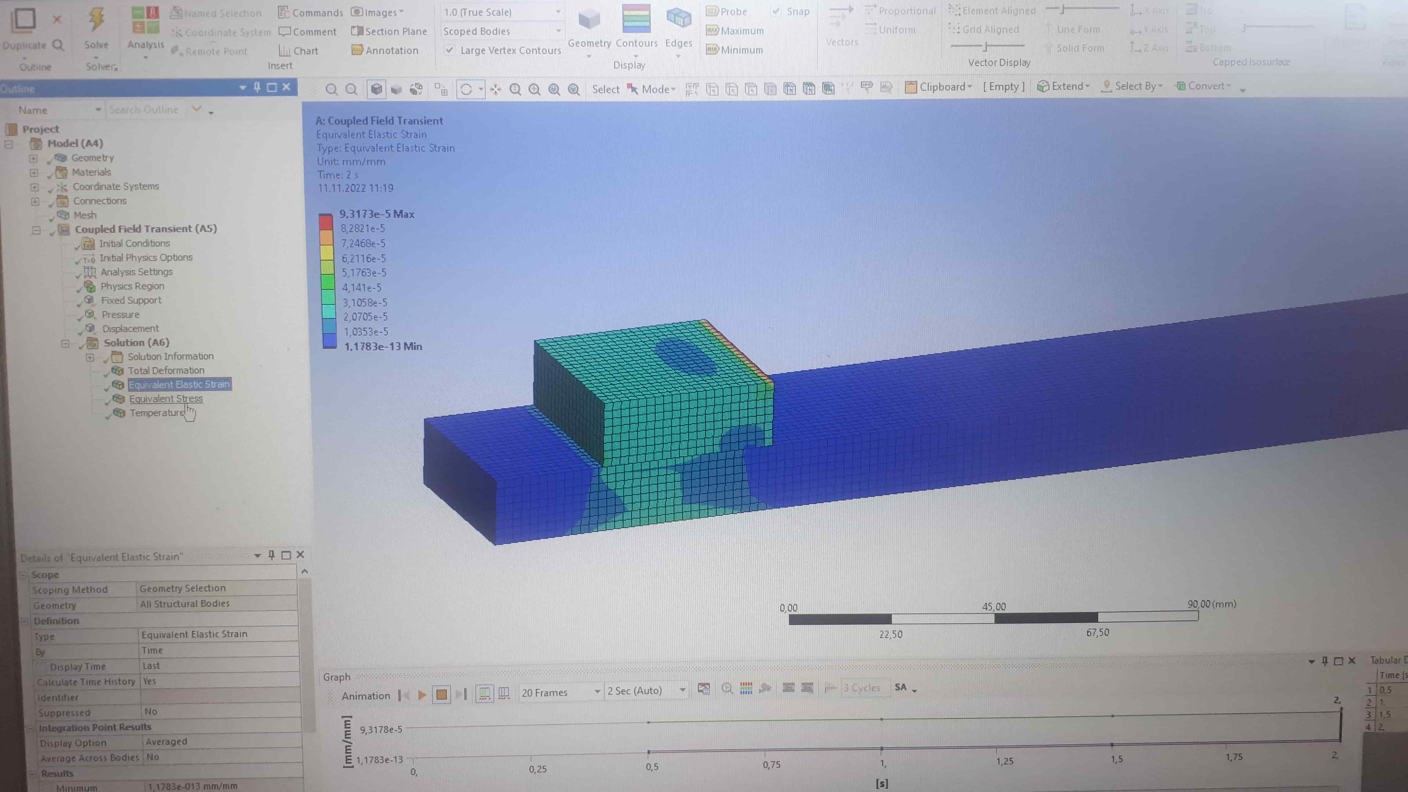

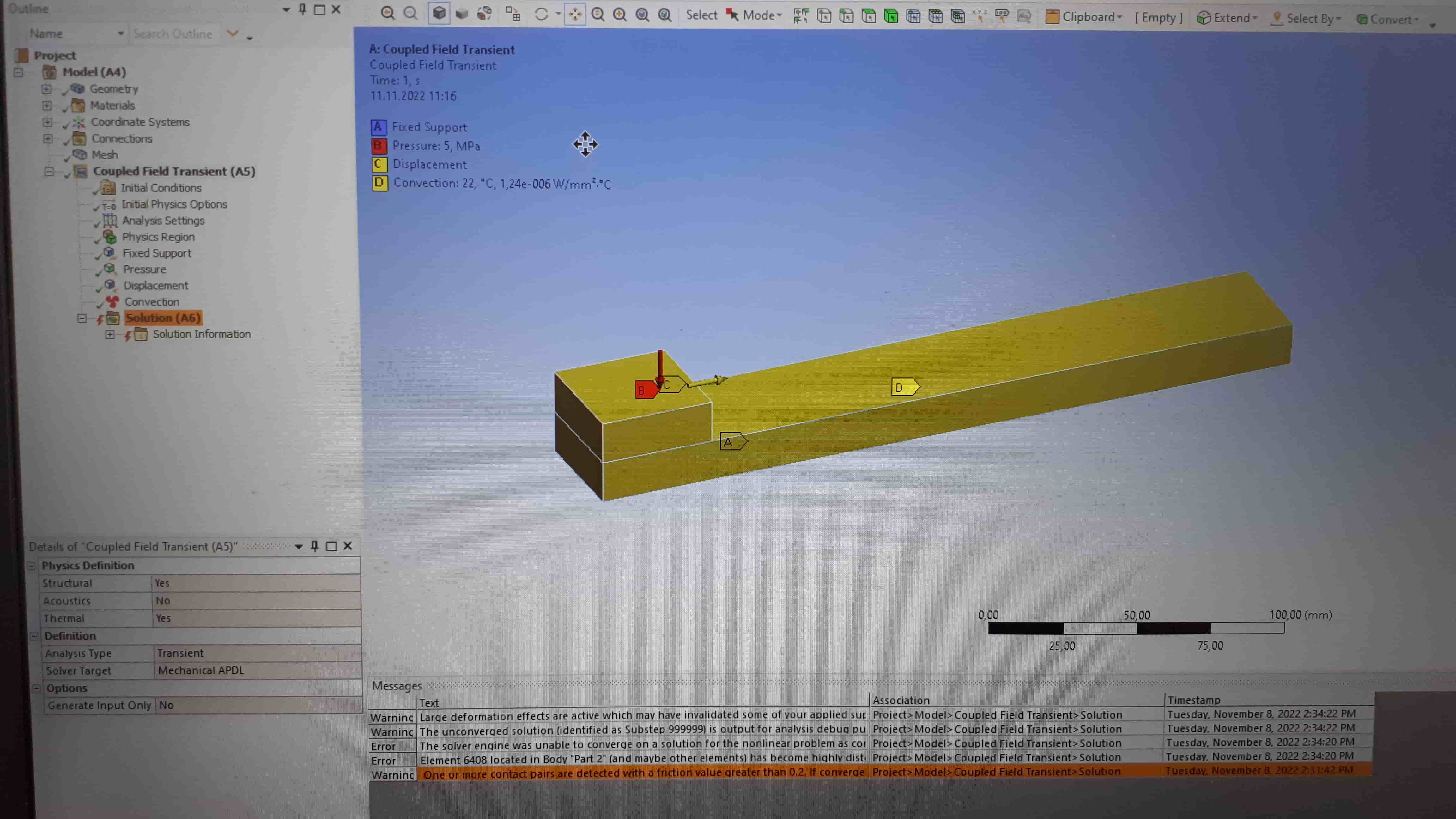

Since my research location is related to the frictional behavior of 3D solid models, I wanted to start my tests with simple models as seen in the photo. I think I can perform my tests in Couple Field Transient analysis since I can control the mechanical and thermodynamic properties of the models in the same way. When the connection between the two parts is no separation, the problem is being solved; When the connection in question is defined as friction, the problem gives the error in the photo. I just entered the coefficient of friction to define the friction link and left everything else to program control. Since the connection type is frictional, I assigned a convection coefficient to the material against the heat that will occur.
When I watched other videos on the internet, I noticed that friction problems were solved in Couple Field Transient with 2D analysis or in Transient Structural using APDL. However, these solutions will not work on advanced models. I would be glad if you could help me to solve this problem.
Unsuccessful Frictional Analysis
Successful No-Sepreration Analysis
November 11, 2022 at 9:14 am
Erik Kostson
Ansys EmployeeHiÂ
There is an example similar to what you are trying to model above, in our help manual and under the workbench techn. show cases:
Chapter 28: Friction Stir Welding (FSW) Simulation
Chapter 28: Friction Stir Welding (FSW) Simulation (ansys.com)
All the best
Erik
