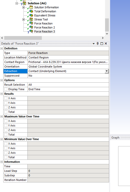

      I'm trying to check the compensation strength for a contact, I transfer the contact to a solution, a force reaction appears, but it doesn't work and nothing lights up yellow, why?

      In output controls, activate the nodal forces as shown below.

        Thank you!
