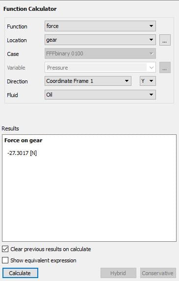

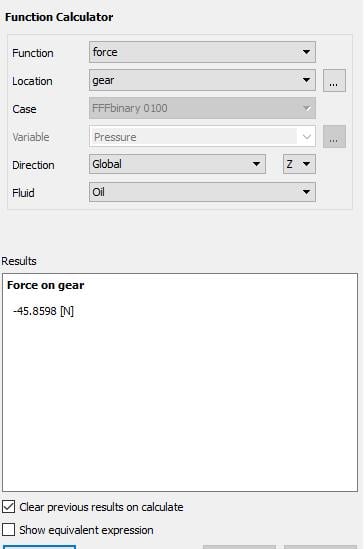

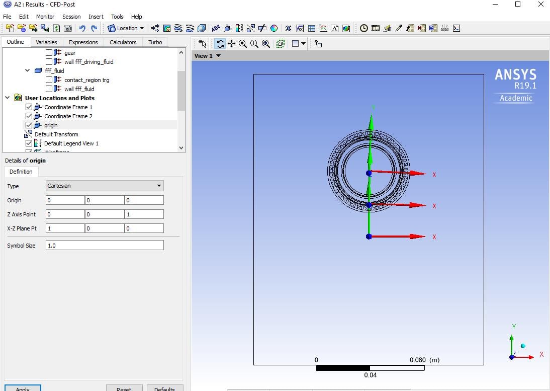

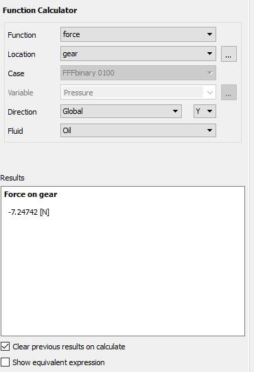

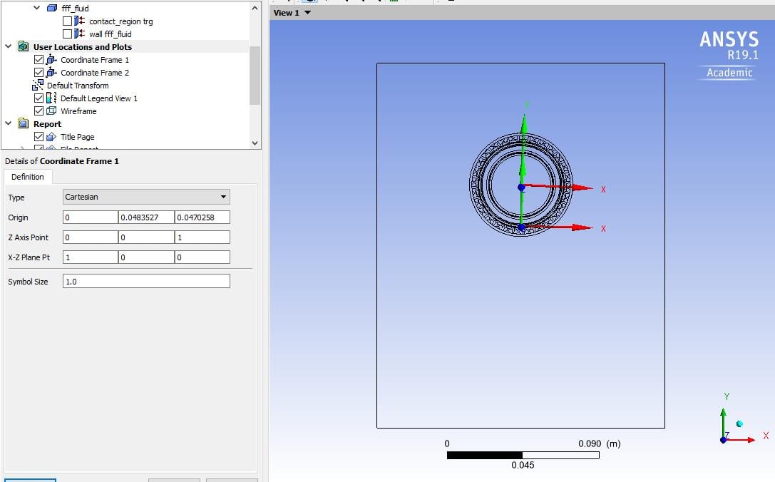

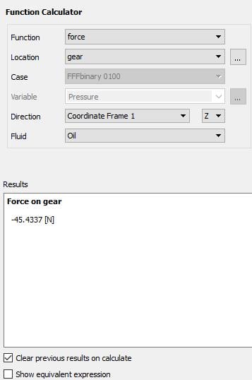

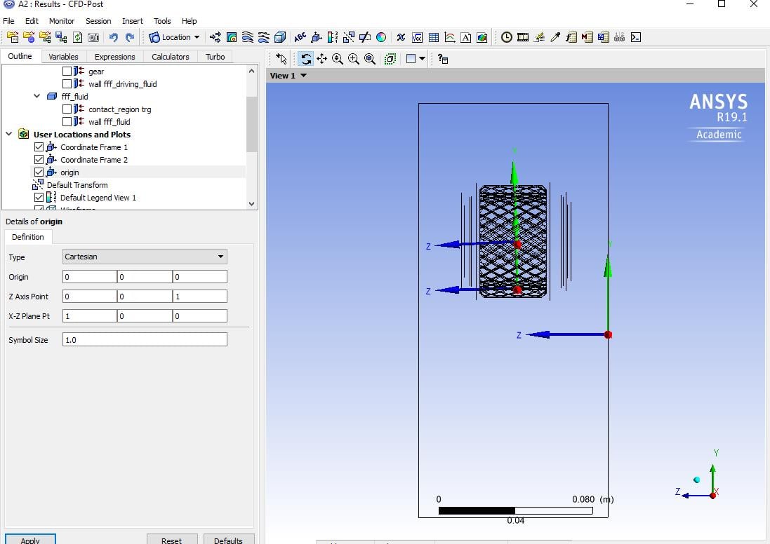

    • marduin
      Steve,
      When using the function calculator to calculate force the only change is which coordinate system is used, as seen in the images below.
      the coordinate frames were created with the settings in the images below
      Assuming that the global coordinates are at (0,0,0) the global coordinate system is as follows
      The only thing changing between the coordinate systems is the origin point, so I don't get why the force is changing especially for the y force as the coordinate system is changed from global to coordinate system 1.  The x and z forces also change a little but not as significantly as the y force.  As seen in the following images.
