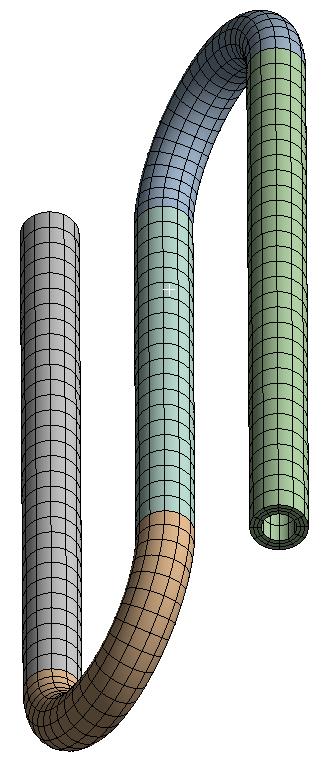

      I got the error a software execution error occured inside the mesher. The process suffered an unhandled exception or ran out of memory.
      That has happened to me when I have "bad" geometry, like tiny edges, sliver faces, etc.
      If you attach your project archive file .wbpz to a reply, I will take a look.
    • Langas
      https://mega.nz/#F!2HpX2RSZ!fsGMkBe5h4pj_5q1VudsFg
      Didn't have any memory problem. Attached is an ANSYS 18.2 archive.
      Download this and use Workbench to File, Restore Archive.
      There are 3 elements through the thickness and nodes plus elements less than the Student limit.
