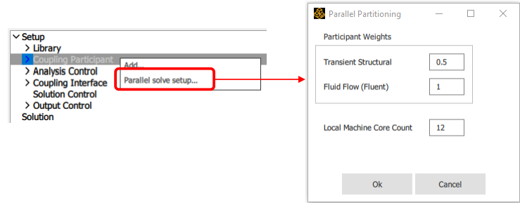

      • Question 2:  I avoided to resolve using System coupling GUI because even the Size of the problem is still considered small yet it take days (15 days to achieve 18%) to resolve it, I tried to enhance the speed by changing the parameters (Parallel fraction from 1 to 12 on each side - fluent and transient) but it was without impact on solution speed. please advice. see picture 1

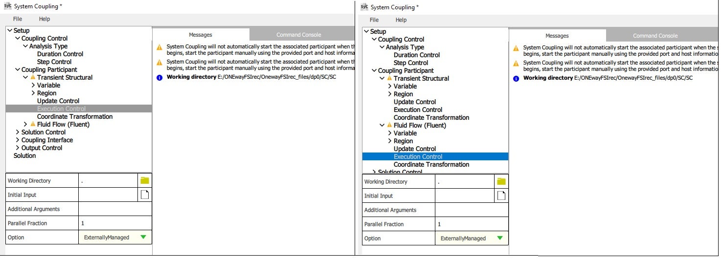

      • Question 3:  in the one_way FSI there is only 1 (one) data transfer from side 1 ( fluent) to side (2) transient structural... am I right? see picture 2
    • Rahul

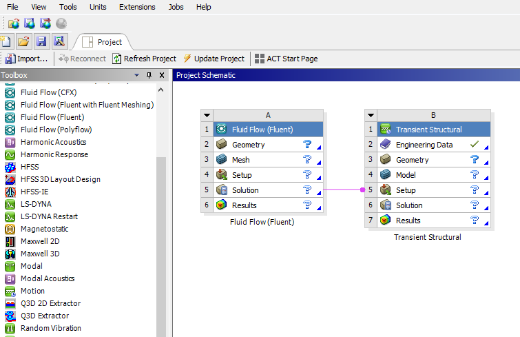

      Yes, with One way FSI data transfer happens only in one direction without any feedback from recipient. As it is one-way coupling you can do it in WB itself. You can add both participant in SyC GUI and one data transfer from from Fluent to Mechanical (for 1 way FSI).

      Please refer Using Parallel Processing Capabilities (ansys.com) for use of parallel processing capability of System Coupling. RMB on 'Coupling participant' and click on 'parallel solve setup' specify the faction of cores to be used for each participant and total number of cores available. e.g with 12 cores available and fluent fraction of 1 and mechanical fraction of 0.5 will use 12 cores for fluent and 6 cores for mechanical.

        yet, I still have a problem excuting the 1-way (one way) FSI.
        the concept of this method is two export the load ( force on the blade surface) from fluent to transient structural so we can plot the displacement per time.
        I tried to create the data transfer (one data transfer) - force from fluent side -side1- to target transient structural -side2).
        but I could not plot the displacement as I could not find the function to do.
        I tried top dit via the external data transfer but because the number of the data point it could be impossible to do it so the coupling system is the only option.
        please advise
    • Rahul
      You can also do it in WB environment.

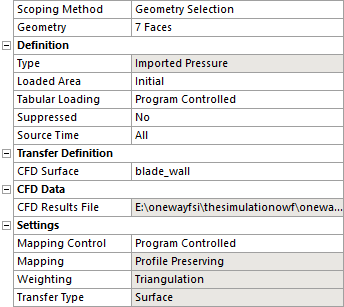

      when it is transient, the transfer of the load take only the final value of the transfered force.
      I tried also via this method but I could not plot the time function, also using external data to transfer the load does not work as it is limited to 10 value, I have a 500 Hz load??
    • Rahul

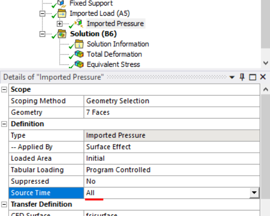

      It will import the data for all time steps if source time option 'All' is selected.

      • mohammedlaminemekhalfia
        Dear Rahul.
        I tried with the suggestion you offered but I still have he same issue and the same problem.

      Try with the 'Mechanical based interpolator'. 'CFD based interpolator' will just import last time step results. let me know if that helps!
    • Funke Dacosta-Salu
      The result is the same for 'CFD based interpolator' and 'Mechanical based interpolator'.
    • Rahul
      It should work with the ' Mechanical Based interpolator'. Please refer Using Imported Loads for One-Way FSI (ansys.com).
