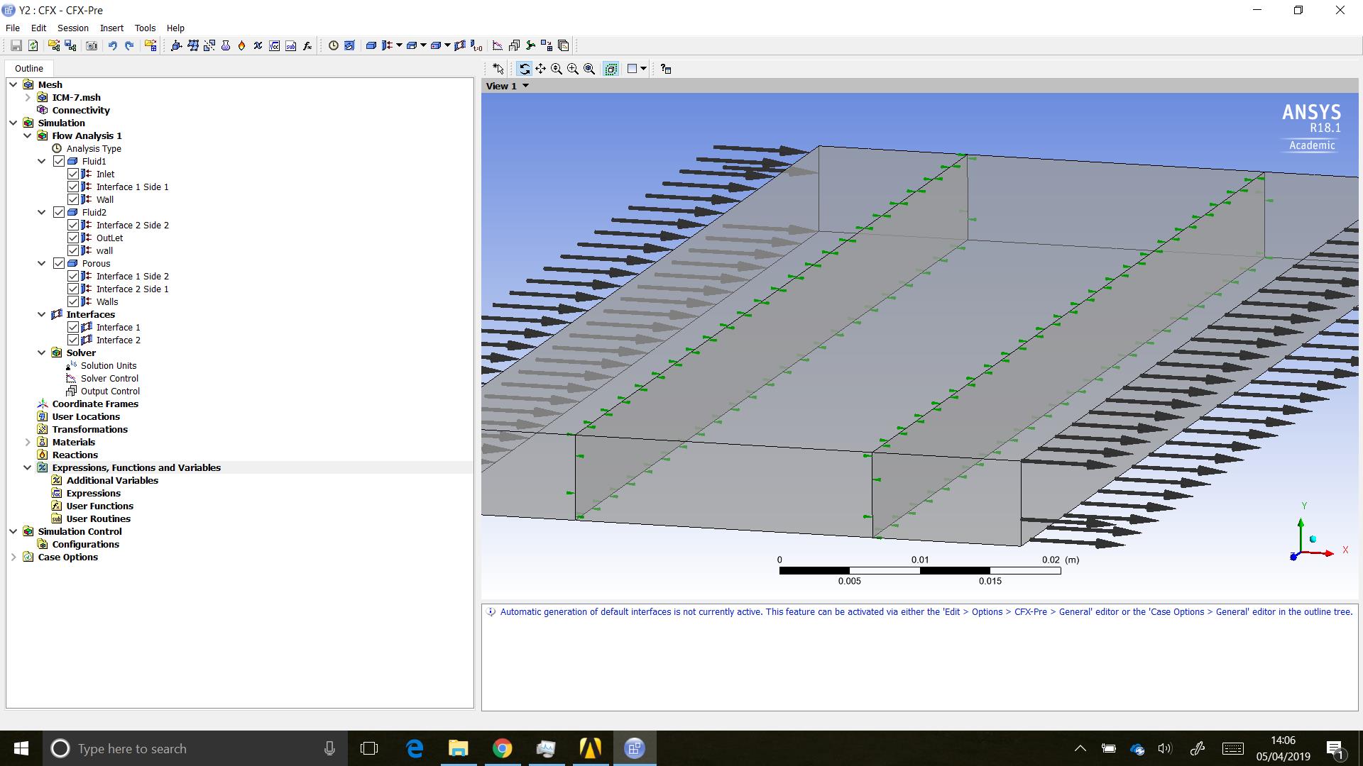

SubscriberI have a porous fluid interaction but mass isn't conserved across the interface. The velocity gets 10 times higher after convergence. I have used both structured and unstructured mesh and GCI mesh connection so seems no issue of conformal/non-conformal mesh. The flow is simple Laminar. Volume porosity is 0.1

Ansys EmployeeGoenitz: It appears that your post is unrelated to the original question in this thread. Please post this question as a new entry.

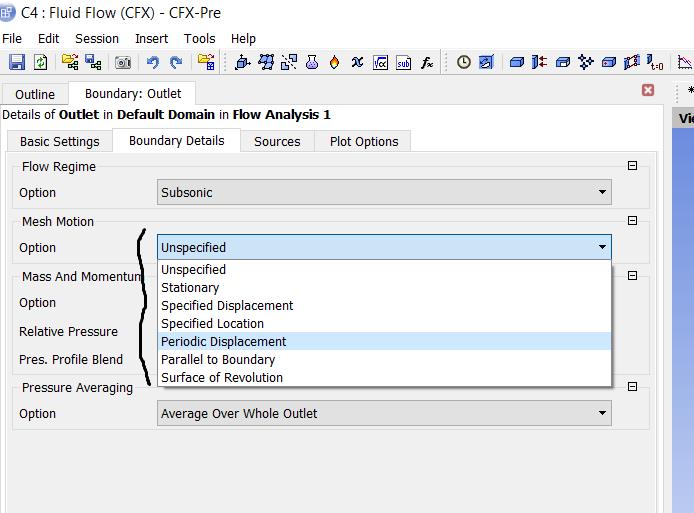

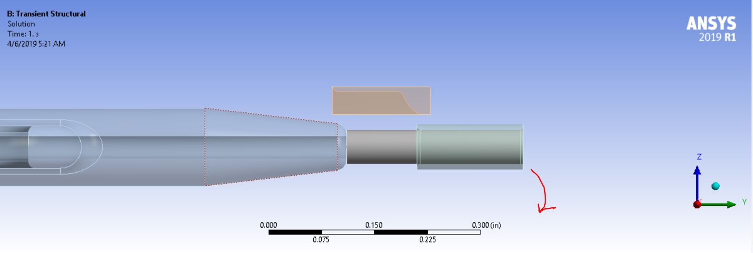

To further add, I have done some personal investigation and think I am on the right path... I have created a solid fluid portion inside of the catheter, with the "Inlet" defined on the left side (within the anchor), and the outlet is within the rigid tubing on the far right hand side that will rotate down via rigid joint at -30 degrees:
of note: The rigid tubing is not rotating AT the very far right, but rather at the far left of the most outer sheath as is displayed above.
Within CFX, I have defined my Inlet as stationary, as it should not be deformed nor change outside of the rigid tubing, and my wall is system coupled with a FSI interface within the tubing defined in Mechanical.
My question: What do I do with the Mesh Motion Outlet condition since that face will effectively be rotating as a rigid joint at -30 degrees? The rigid joint is currently rotating the -30 degrees over t=1 s in transient structural.Â
Is some form of cos, sin expression necessary for this? Are there any examples that I could follow?
