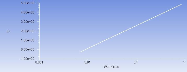

Subscriber Dear all,
I am having extreme difficulty getting this to work. Likely because I have no clue what I am doing.
Iam required to compare the law-of-the wall profile to the Uplus v Yplus computed in fluent for a K-omega SST turbulent flow.Fluent gives Yplus but not Uplus.
I tried defining Uplus as a Custom Field Function, my yplus<1. For uplus =ylus i usedÂ
I got
For logarithmic u+Â
My question is: how can plot the famous TBL curve U+ vs y+, to detect the 3 zones ?
Best regards,
SERRARE

Amine Ben Hadj Ali
Ansys EmployeeYou need to define y+ and u+. Then create a line at a certain position normal to a wall then you can xy plot to plot the profile you want. U+ is the velocity in the cell / square root of wall shear stress divided by the density. -
