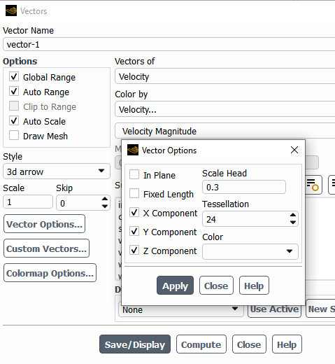

SubscriberI am modelling water flow in a horizontal straight pipe with periodic bc streamwise in Fluent. How can i get the cross-sectional velocity contour (not the axial velocity on the cross-section but the velocity actually existing on the cross-section, i.e. the flow going downward and upward) and in plane velocity vector magnitude. I used vectors on a plane of pipe cross-section and turned on the tangential option (in projection setting). But the order of magnitude of the axial velocity and this tangential option are coming same which cannot be the same because the flow should go much faster in the axial direction. Am i doing something wrong? basically i want to extract the cross sectional velocity going upwards and downwards. thanks, i am using CFDPost and CFDPost is showing vector magnitude taking all the 3 components but i want only y and z components on the plane.

Look in Vector Options, you may want in plane?Â

Subscriberwhat i have done is define a new variable as sqrt(v2+w2) and plot the vectors according to it-i hope it is giving correct results now. In plane also takes all the 3 components.

SubscriberBut this option is not in CFDPost..I think you are showing fluent postprocess
January 30, 2025 at 7:35 pm
scabo
SubscriberAlso even in this if you do inplane then also the magnitude showing is all the 3 components included, but i only wanted vectors to be colored by the cross section vel magnitude(y and z comp). So even if i de select the x comp, still it does not do the job and the legend remains same including all the 3 components. So i think i need to define a new variable consisting of y and z and them plot it according to that.

Forum ModeratorI am - why would you be using CFD Post? Unless you've run the model in CFX.Â
January 31, 2025 at 11:54 am
scabo
SubscriberActually i run on HPC and then it saves the data which i post-process using CFDPost. But i can also open it in Fluent as well.
January 31, 2025 at 12:01 pm
Rob
Forum ModeratorOpen and look in Fluent. CFD Post was the "recommended" option for a few versions, but few Fluent users made the switch, and we reverted (officially and otherwise) to Fluent for post processing several versions back.
