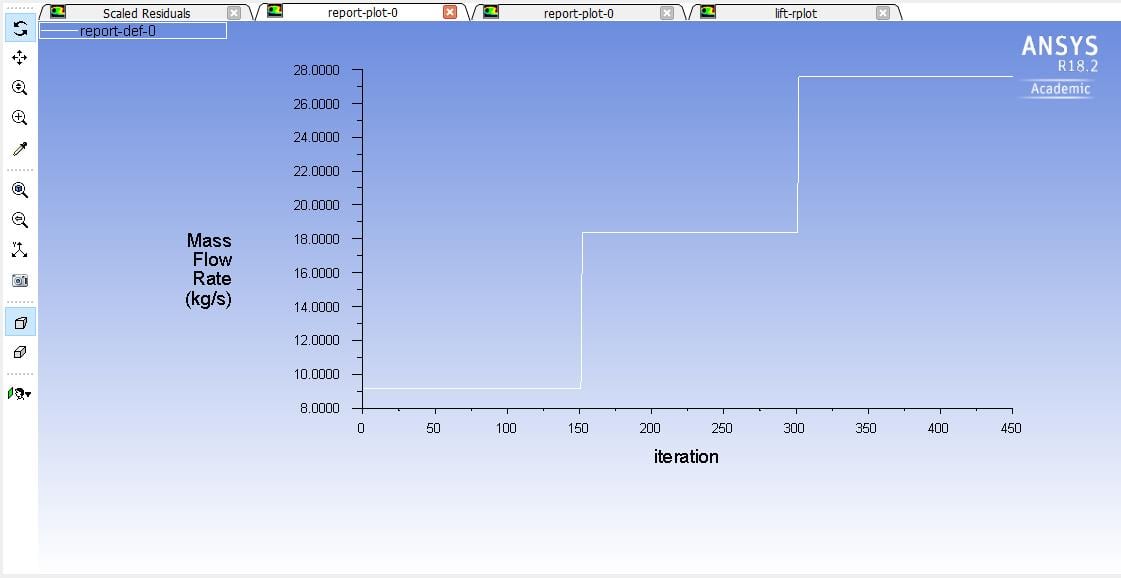

      I'm currently having a problem getting the velocity inlet in my Fluent project to work as I wish. Maybe you may help.
      The boundary conditions are set as shown in the figure attached (the wall section is a simple airfoil section on a tube).
       I want the velocity to increase from 5m/s to 50m/s with time during the transient simulation so that the winglet is not instantly loaded with large aero loads. this way the FSI simulation is more gradual and stable.
      Through a simple UDF I managed to get the velocity to increase with time but this is in turn creating a problem in static pressure (gauge) as shown in the second and third figures attached.
      I tried several methods to fix it but i m ending up with the same problem all the time.
      Do you have any idea how this can be fixed please?
      Thanks in advance,
      Fabio Cauchi

    • FabioCauchi
      The following are some pictures of what you want to see. How can i send you files apart from pictures here please? or an email address?
      Thanks for your time.
      Residuals
      Massflow - Velocity increase
      Lift - Physical convergence monitor
      Static pressure - gradient problem
    • Amine Ben Hadj Ali
      The continuity residual is still high and quite stalling although the other reports are showing convergent behavior towards the end of the transient. What about a screenshot of your UDF?
      A.
    • FabioCauchi
      Continuity goes below e10-3 once more time-steps are ran for the same final velocity (as expected).
      Attached please find the UDF used. I also tried the transient table method (file screenshot also attached). This method creates a udf internally.
      Thanks
