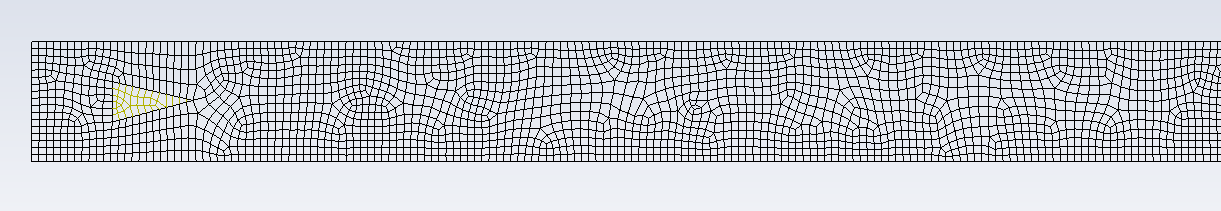

I am trying to run a simulation where a 'rocket' (triangular section) moves laterally within an enclosure due to the surrounding fluid flow pushing it forward.

Forum ModeratorHave a look in the Help system for Fluent. There are two videos that go through moving mesh. In your case I think you've tried to smooth the mesh rather than remesh. nOctober 15, 2020 at 10:41 pmahg
SubscriberHi Rob,nThanks for your advice. Regarding the smoothing, I think that i just a poor screenshot on my part, the re-meshing option (deselecting the smoothing made no difference):n
I haven't been able to find the videos you are referring to, seems like the help only includes descriptions, but I will investigate further and see whether they help. I've tried to follow videos off YouTube, but I can't spot the error.nThanks again for your help,nAtreyn
October 16, 2020 at 11:12 amRob
Forum ModeratorCheck the cell size in your model compared to the remesh criterion too: the defaults aren't always appropriate. nOctober 19, 2020 at 5:43 amahg
SubscriberHi Rob,nThanks again.nI believe the cell size in the model matches the remesh criteria (~max cell size 5.8e-4). A maximum cell skewness is also set of 0.7, which I think should trigger the remeshing, before negative cells occur.nBest,nAtreynOctober 19, 2020 at 10:33 amRob
Forum ModeratorI should have spotted this, check 11.6.2.3 in the Fluent User's Guide, Solution mode, 2020R2 documentation. nOctober 22, 2020 at 6:37 amahg
SubscriberHi Rob,nJust to clarify, are you saying that using a triangular mesh will resolve this? I have tried this with the local cell remeshing and a triangular mesh, and am now receive a floating point error.nI am still messing around with the settings to hopefully try resolve this as it does appear to be a different problem.nThanks a bunch.nAtreynnEDIT: It appears the floating point error occured because I had switched to a pressure based solver. If I was to switch back to a density solver the divergence occurs, and negative cell volume occurs again.nOctober 22, 2020 at 10:50 amRob
Forum ModeratorIs the solution remeshing, and then failing?nOctober 26, 2020 at 12:27 pmahg
SubscriberHi Rob,nThe solution looks to just be failing. No remeshing appears to be taking place - is there any way to check in the logs or similar?nThanks,nAtreynOctober 26, 2020 at 1:51 pmRob
Forum ModeratorLogs tend to tell you what happened, what you want is images at each mesh update. If you display cell size how does that compare to the remesh settings? nOctober 31, 2020 at 5:38 amahg
SubscriberHi Rob,nThanks for your advice. I was unable to get this dynamic mesh to work, so have opted for a different approach. As such, am happy to close this thread. nThanks,nAtreynViewing 10 reply threads- The topic ‘Fluent Simulation Does Not Re-Mesh’ is closed to new replies.
