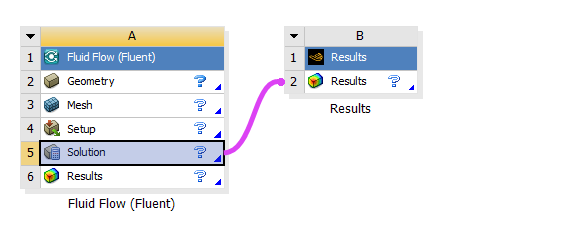

      I’m facing a problem in ANSYS Workbench while working on a Fluent CFD project. The Geometry, Mesh, Setup, and Solution modules work fine. But when I try to open the Results module from the project schematic, I get the following error:
      Application failed to connect
      Interestingly, when I manually navigate to the project folder and open the .res file using CFD-Post, it opens correctly. So, the result data is not corrupted — it's just not opening within Workbench.
      What I’ve Tried:
      • Refreshed the project and restarted Workbench
      • Checked project directory and file paths
      • Re-solved the project
      • Ensured Fluent is installed properly
      Still, the issue persists.
      Uploaded image
    • Omkar Pawar
      Hi Aryan,
      Please test using a new results tile, as shown in the image below.
      If the issue still persist you may try using a standalone CFD post session and load the case and data file into it.
