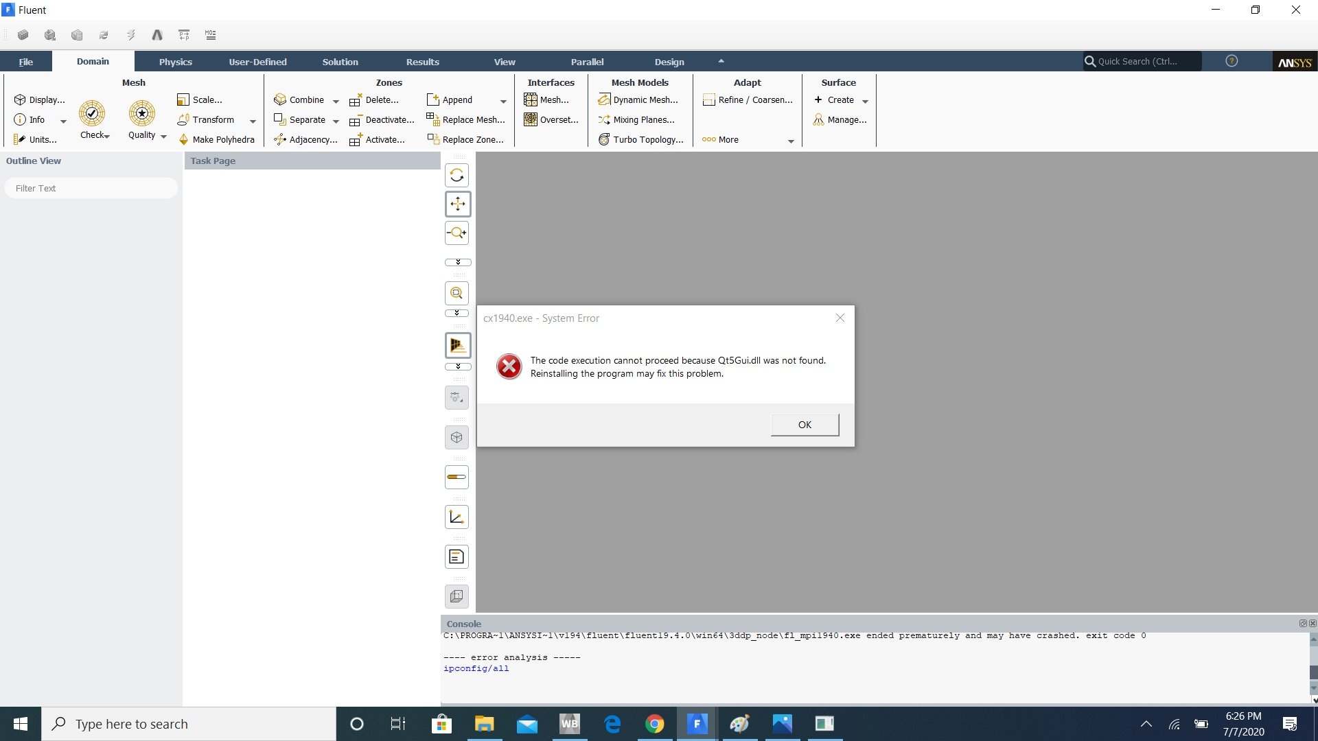

dorianrendon

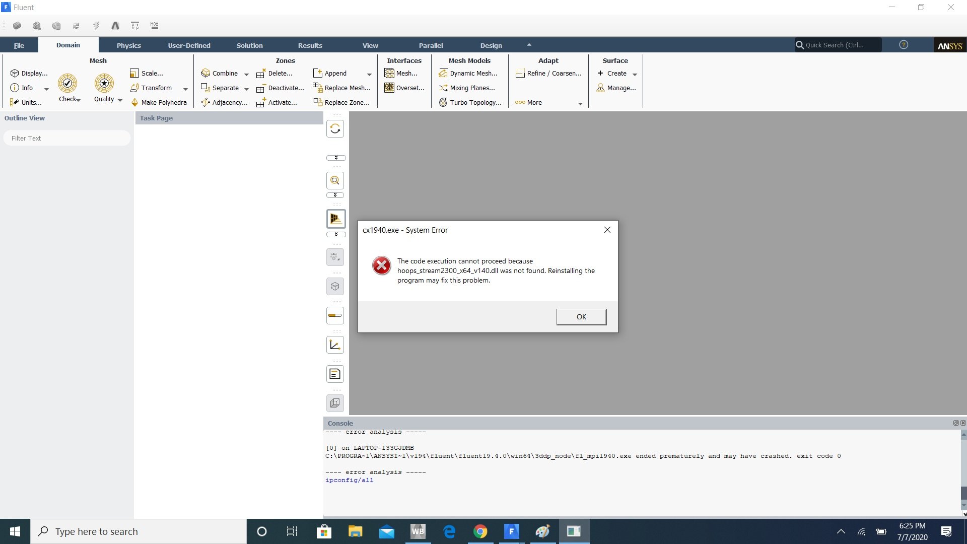

SubscriberI have no idea what is going on with this program... I read the suggested threads:  /forum/forums/topic/fluent-application-failed-to-start/    and   /forum/forums/topic/fluent-doesnt-start-at-all/  but don't really understand what the instructions are... I'm not very good with IT stuff. So I watched a Youtube video https://www.youtube.com/watch?v=9NG3Qc5f68U&t=39s as a guide to upload my Solidworks design and run fluid simulations on it. ANSYS workbench lets me import the IGS file and and do the mesh process too but then when to comes to setup, Fluent fails to start. I also followed the steps in /forum/forums/topic/fluent-19-2-not-working/ but still no success.Â

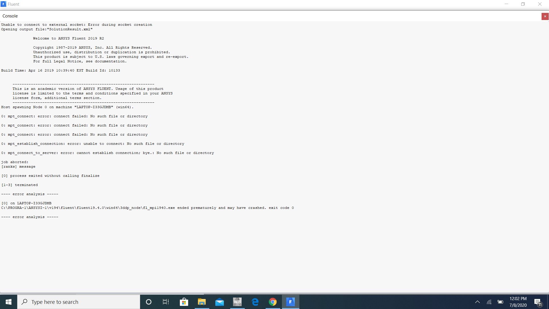

dorianrendon
SubscriberI have no firewall or virus protection on and I have to close Fluent through task manager every time too.

Rob
Forum ModeratorThe error is suggesting it's the University licence manager that's down - have you got Student and a full version of the code on the same machine? -
August 6, 2020 at 8:31 pm
tsiriaks

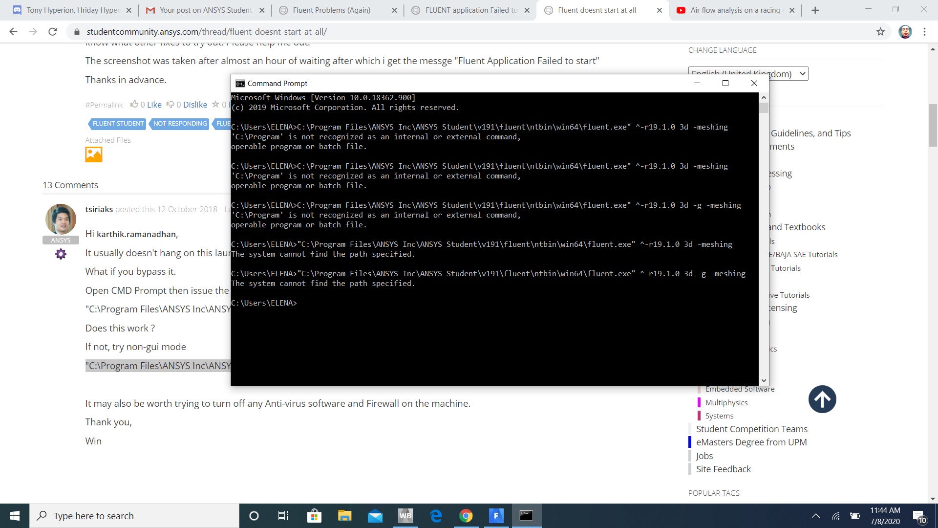

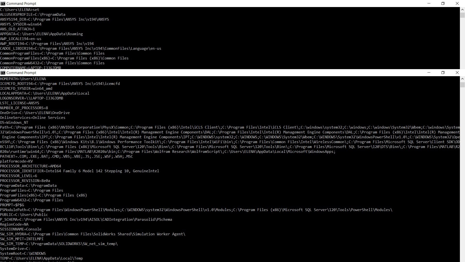

Ansys EmployeeDon't set those MPI and interface. It's a different issue/workaround.nIt seems you can launch stand-alone Fluent but have issue when launching WB-Fluent.nDid you try reinstalling ANSYS ?nTry the following (make sure all ANSYS applications are closed first)n1. Open up Product & CAD Configuration with 'run as administrator' -> Configure Products & CADs -> Select alln2. In the CMD Prompt window, enter the following commandsnset PATH=C:\WINDOWS\system32;C:\WINDOWS;C:\WINDOWS\System32\WbemnC:\Program Files\ANSYS Inc\v194\Framework\bin\Win64\runwb2.exenBefore you try to launch Fluent from Workbench, right click on the 'setup' cell and select properties, then check the box to open up Fluent Launcher when launching Fluent from Workbench. In Fluent Launcher , select Show More Options -> Environment , then type the following in the boxnFLUENT_LAUNCHER_OPTIONS=-driver mswndoes any of these help ?n
