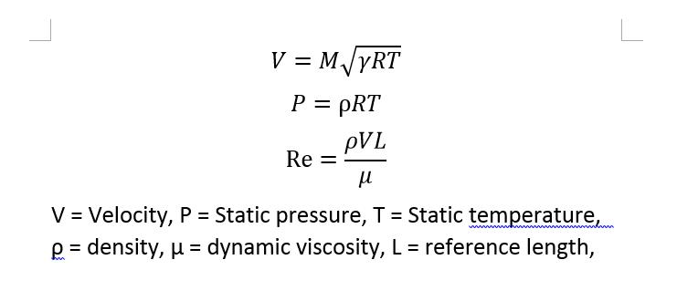

August 17, 2018 at 6:48 am
HHK1992
SubscriberHello Sir,
I have fixed the static temperature at 310 K (based on this website) and calculated the static pressure such that Re = 5.97E6 and M = 0.15. I have used the following relations as attached in the image. On calculating I get static pressure as 25629.5 Pa.
I think since Re and M are maintained as same as that of experiment (in the technical report), cd, cl and cm should be same.
Thank you so much for your time.
August 17, 2018 at 7:47 am
Amine Ben Hadj Ali
Ansys Employee I would calculate the static pressure and static temperature based on isentropic relationships to get static values from stagnation values. The reference temperature might be the stagnation one. P0 is the ambient total / stagnation pressure. The case is very sensitive to Boundary conditions.
We have done the NACA0012 for AoA of 1.55 ° and Ma=0.7 and the results were fine.
