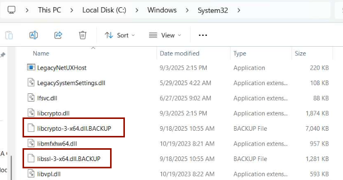

SubscriberHi, I am trying to use Fluent, and it just opens and then quickly closes itself. I have already redownloaded fluent and run the configurator. The other Ansys products work well (I tried mechanical, SpaceClaim, etc). I am not sure what the problem is any more. I am using the student edition, freshly downloaded straight from website.

SubscriberUpdate: I ran it in workbench so I can get more error message details. This is what I got:
The FLUENT application failed to validate the connection.
October 2, 2024 at 3:48 pm
tt01oliverzeng
SubscriberBuild Time: May 13 2024 11:28:30 EST Build Id: 10192 legacy Provider loading failed EVP_DecryptInit. could not load the shared library

October 13, 2024 at 4:48 pm
daniel.schafhaeutle
SubscriberI got the exact same error too. Using Student edition.Â
October 13, 2024 at 5:28 pm
tt01oliverzeng
SubscriberMy understanding is there is something wrong with OpenGL. Another program may have downloaded a different version than what Ansys utilizes. So you have to find said program file and remove it, but then the other program will stop working (might stop working). I gave up trying to figure out which one, so I just reset my windows (clean reinstall). Really dumb and not really a good solution, but it works. If you figure out any other solutions, please let me know!!!
