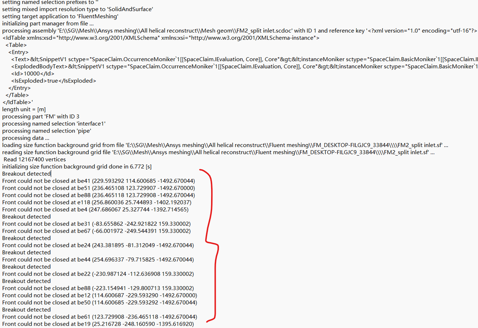

      I checked out TUI again and found the Breakout is shown. I'm not clearly understand the message. The message is shown below.
