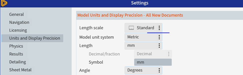

      We would definitely recommend to use native formats as those will carry all the share topo, NS information which will be missing from neutral format like STEP. Could you please provide more details on the Dimensions? It appears to be issue with dimensions. Like the model size seems very large. Could you please try meshing the scaled down model of this? maybe 10 or 100 times scaled down model?
      Secondly, try using standard unit system in the discovery instead of large unit system. Let me know on how this goes.

        Surface meshing works for a 1:1000 model constructed using the Standard Length Scale Unit System, but fails when constructing a 1:10 or 1:100 model from scratch. Constructing the model in 1:1000 scale and then scaling up to 1:10 seems to work. However, the 1:1 scale desired requires the Large Length Scale Unit System.

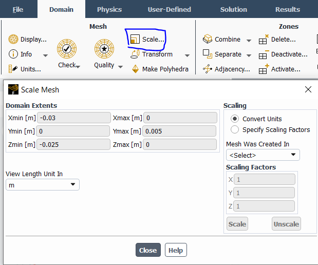

      Thanks for the update and testings. Yes, this issue is due to large dimensions, so working on the scaled down model is recommended currently. This will be improved in our upcoming versions. Time being you can work on the scale down model and then later scale the mesh in solver to actual dimensions.

      P.S. For anyone following the thread experiencing similar issues, the workaround that is currently working for me is opening up the 1:1000 scale model constructed in Discovery in SpaceClaim and scaling up to 1:1 there, as working with a 1000th-scale, scaled-down model is not an option for the scope of our current project. For completeness sake: performing the entire construction (!:1000 scale) then scaling up entirely in SpaceClaim also does not work (similar errors to those described above).
      I have yet to attempt scaling up in the solver, as I was unaware that this is something that could be done.

      Yes, in the solver we can scale up the model in appropriate units before we solve it.
