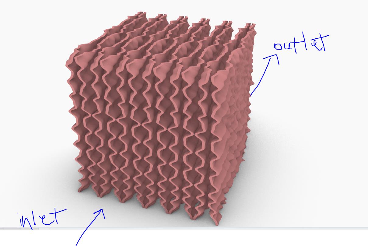

      Hi
      I want to simulate airflow passing through some curved surfaces. They do not interface with each other but all of them together are supposed to represent one geometry.
      I defined a fluid domain for it (the big rectangle). I did the meshing and everything looks ok (I'm a beginner user, so just because there was no error, it looks ok to me). However, when I go to the setup phase, only the bigger box (fluid domain) is showing and the geometry (curved surfaces) are not inside it.
      What is the problem here? Is the meshing wrong? (I also checked the boundary conditions in the setup, there is inlet outlet etc, except for the curved surfaces.)
      You need to subtract the wavy volumes from the larger one. In CAD you can have overlapping geometry as it's a visual tool. In CFD the volumes need to be connected (know about each other).

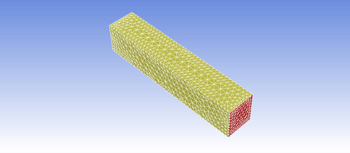

    • KianaMousavi
      Could you please explain why the bounding box should be a bit smaller?
      (in the image below, I reduced the geometry to only two sets of curved walls because it is a repeating geometry, and also reduced the fluid domain. the bounding box now is 50*8.5*30 cm )
    • Keyur Kanade
      reducing bonding box will take less time to mesh or give error. this only to identify problem. once problem is identified and fixed, you can use your original bonding box.
      now right click on error message and select problematic geometry. then carefully observe the geometry at location. you may need to fix geometry at that location or change meshing size or use virtual topology etc.
      there are may posts on meshing on this community. you can also search through.
      Keyur
