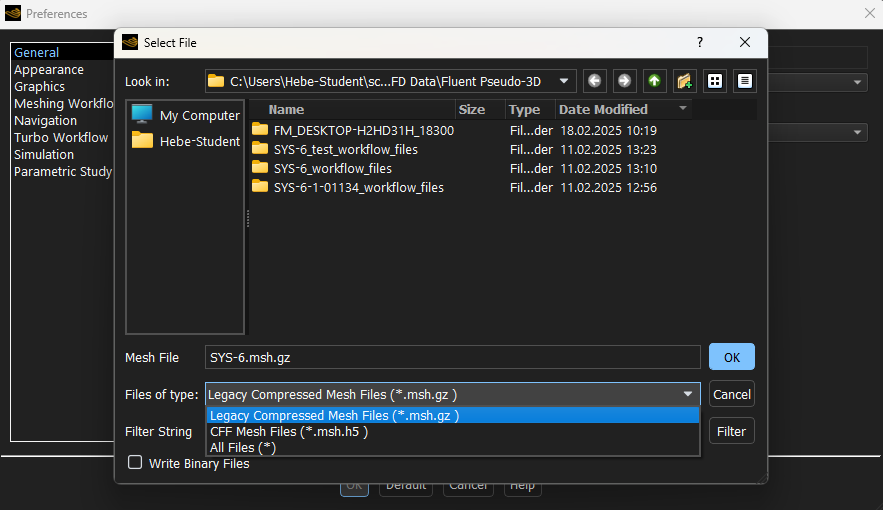

I am using Ansys 2024 R1. I want to export my mesh from Fluent meshing to a Ascii file. In older posts (from 2022 and 2023) it was said, to simply uncheck the Box "Write Binary Files" in the export window. I did this, but didn't get an Ascii file. So i tried with the "Write Binary Files" Box checked and it seems that in both cases I get the exact same binary file.

October 11, 2024 at 3:16 pm
Rob
Forum ModeratorWhat format did you write? Ie .msh.gz or .msh.h5 ?
February 11, 2025 at 8:21 pm
Friggi.Mon
SubscriberI have the same problem. I want to load the mesh in python with meshio but meshio cant read the .msh.h5 format. i tried to export the mesh and change the format to .msh and and it worked but i dont think that thats the intended way. I also doubt that the mesh is correctly loaded.
February 12, 2025 at 9:43 am
Rob
Forum ModeratorChange the Preference save to "Legacy" and that should give you .msh

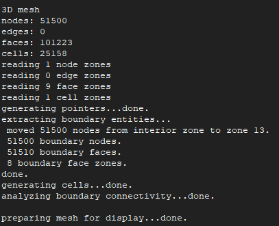

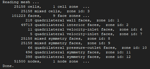

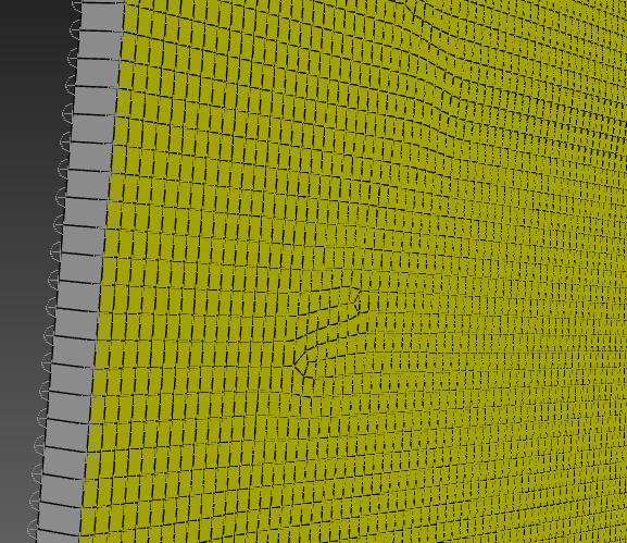

SubscriberI’m sorry for the confusion, English is not my native language and probably i dont understand Ansys not well enough. I want to ensure spatial connectivity in a clustering process and therefore wanted to use the mesh for an adjacency matrix, but the Fluent Meshing works only with 3D data. So i recreated the simulation as a 1 layer pseudo 3d case (see attached image) and exported the mesh as mentioned above.
Key Mesh Requirements for Adjacency-Based Clustering in Fluent:
1. I need to make sure the mesh file actually includes volume cells. If the file only contains boundary faces, the adjacency algorithm won’t find interior neighbors. I think thats where the problem is. When i write the mesh there is a console output that says “moved nodes from interior zone to zone 13.”
The console output from reading the case data looks like this:
2. For meshio the format should be ASCII to ensure that the python script can parse the data.
3. Ideally, the mesh should keep cell IDs consistent with the solver (e.g., CGNS “Cell_Id”) so I can match adjacency results to flow data. This prevents indexing mismatches between my volume mesh cells and the solution data.
4. For adjacency-based connectivity, I need to confirm that “interior” or “fluid” cell blocks are properly separated from boundary face zones. Typically, volume cells live in a single fluid zone(cell zone), while inlets/outlets/walls are separate face zones.
5. my simulation is pseudo-3D (a single extruded layer), my mesh must reflect this in actual 3D cell types (hex)
I understand if this is not enough information for remote diagnostics but i really appreciate your help so far. -

Forum ModeratorThat's a 3d mesh, and you've got a cell zone plus interior facets for the fluid region; the latter being the sides of the cells. Cell ID may or may not be retained between mesh and solver as Fluent doesn't need cell ID from meshing; it's used to link the cell for the data file only.
The mesh format is covered in the User's Guide, https://ansyshelp.ansys.com/public/account/secured?returnurl=/Views/Secured/corp/v251/en/flu_ug/flu_ug_app_form_case_data.html

February 21, 2025 at 11:21 am
Rob
Forum ModeratorI'm not allowed to download files: there are some rules to keep me out of trouble with the Export legal team and IT.
Yes, that's a 3d volume mesh as far as Fluent is concerned.
