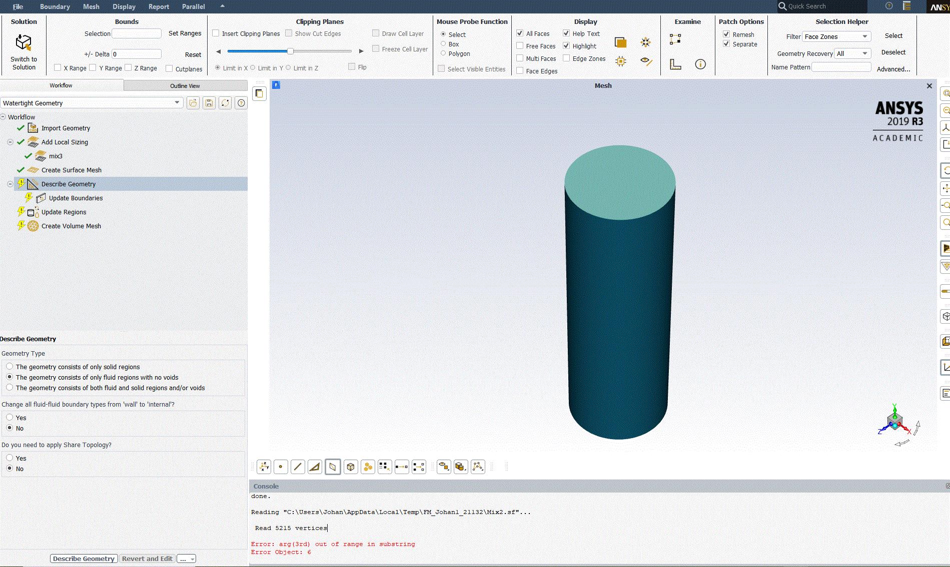

SubscriberMorning,Â
I'm not importing. I created the pipe (and the previous bodies that gave the same error) in SpaceClaim.
If I don't select "Add local sizing", this error doesn't come up. Then I can create a much more complex body and still mesh it.
In this complex body, the mesh went up to 105175 boundary nodes, 207326 boundary faces and 1163223 cells in the volume mesh. No error. In the academic version we should be able to go up to only 512k ?

Ansys EmployeeWith student version you can only solve 512K. Check following link.Â
https://www.ansys.com/en-in/academic/free-student-products

Ok. But I managed to mesh and "calculate" the equipment. It just didn't want to "write to the server". Then I get this message - exactly as you said.
