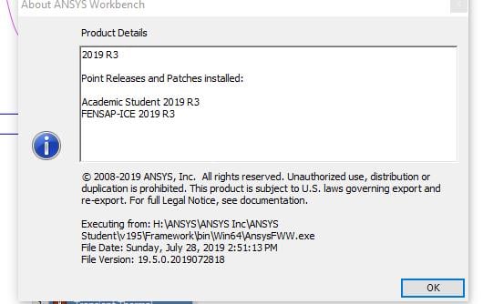

      Thanks very much for both your replies. However, even when selecting "edit" on an already-existing material like aluminum, the properties section remains blank. Furthermore, within the new materials select window, all values for a given substance are greyed out and cannot be edited. I am attaching screenshots of both these cases as well as a picture of my version number, which I believe is ANSYS student 2019 R3.

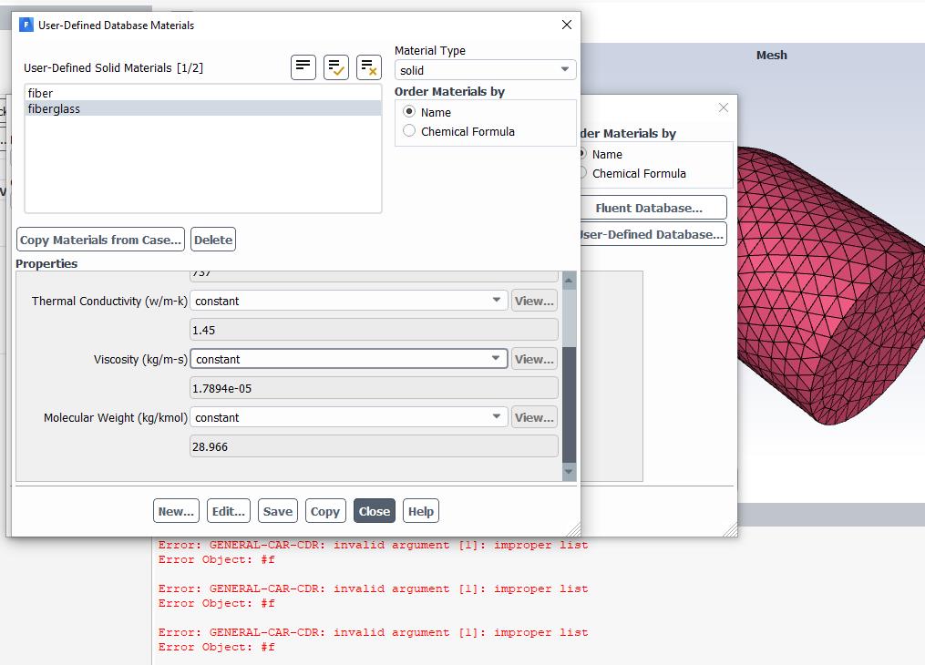

      I have been able to create a user-defined entry using textedit, however to do so I basically copy/pasted the structure I saw on the CFD forums for air, creating the following document:
      (fiberglass solid
      (chemical-formula . #f)
      (density (constant . 2460)
      (premixed-combustion 1.225 300))
      (specific-heat (constant . 737))
      (thermal-conductivity (constant . 1.45))
      (viscosity (constant . 1.7894e-05)
      (sutherland 1.7894e-05 273.11 110.56)
      (power-law 1.7894e-05 273.11 0.666))
      (molecular-weight (constant . 28.966))
      After saving this as a SCM file, I have opened it in Fluent and this window popped up again:
      I have tried pressing "close", "save", and "edit" but in none of these circumstances does my new material seem to be input.

      Yes it is wrong that is why I described the correct way to do it there are some brackets missing.
