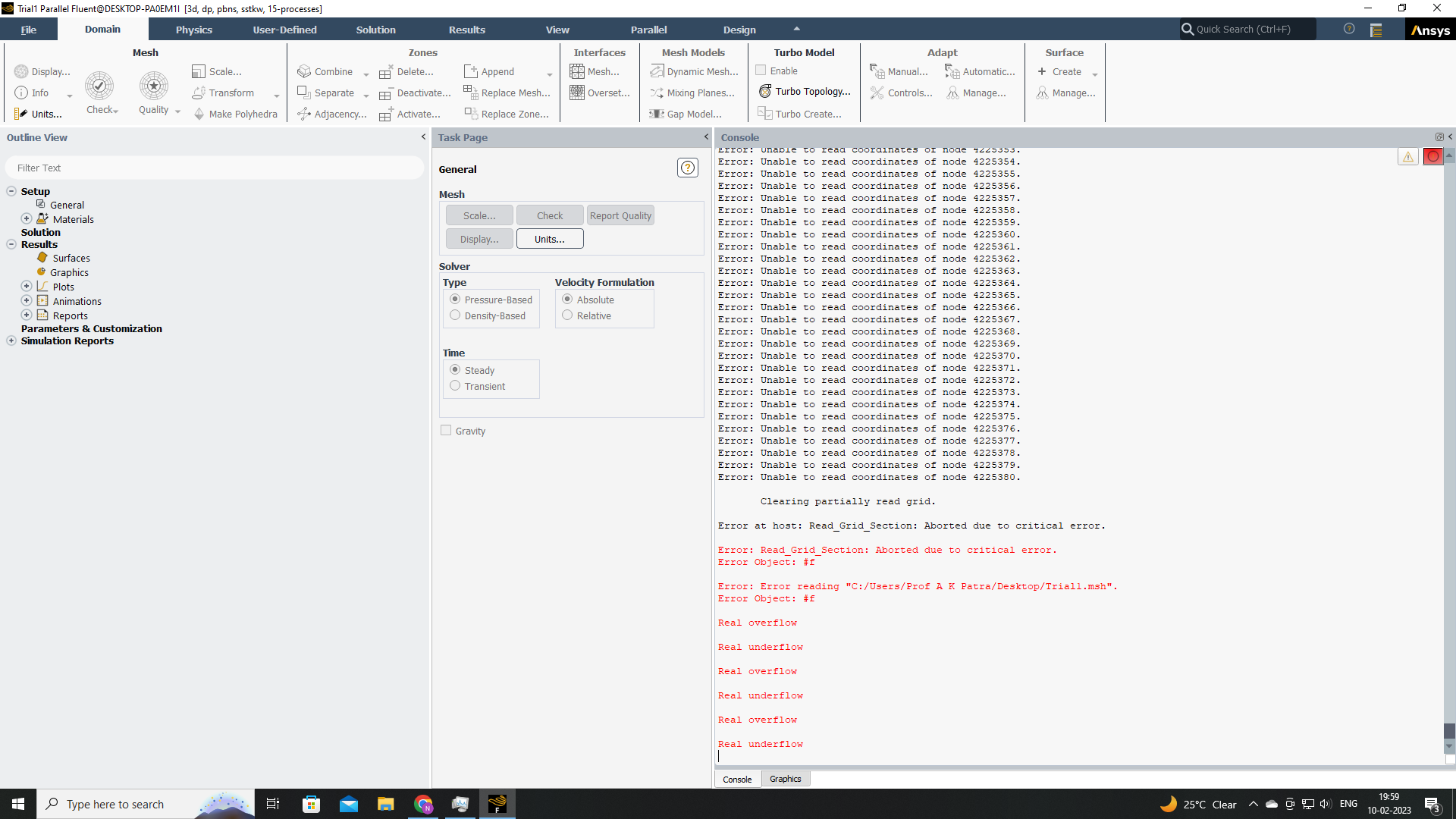

      I have created my mesh externally but when I am importing my mesh to Fluent, it gives the following error and same is the case for every node in the mesh.
      ERROR: Can't read the co-ordinates for node 4555678.
      Your help is highly appreciated.

      I created my mesh in OpenFOAM and converted it to Fluent format. The mesh obtained had extension .msh which must be fine but when I am importing my mesh in Fluent , I get the following error
      Assuming the mesh is 3d, is there an error at the start of the read in process? The failure to read the coordinates could be a result of that.

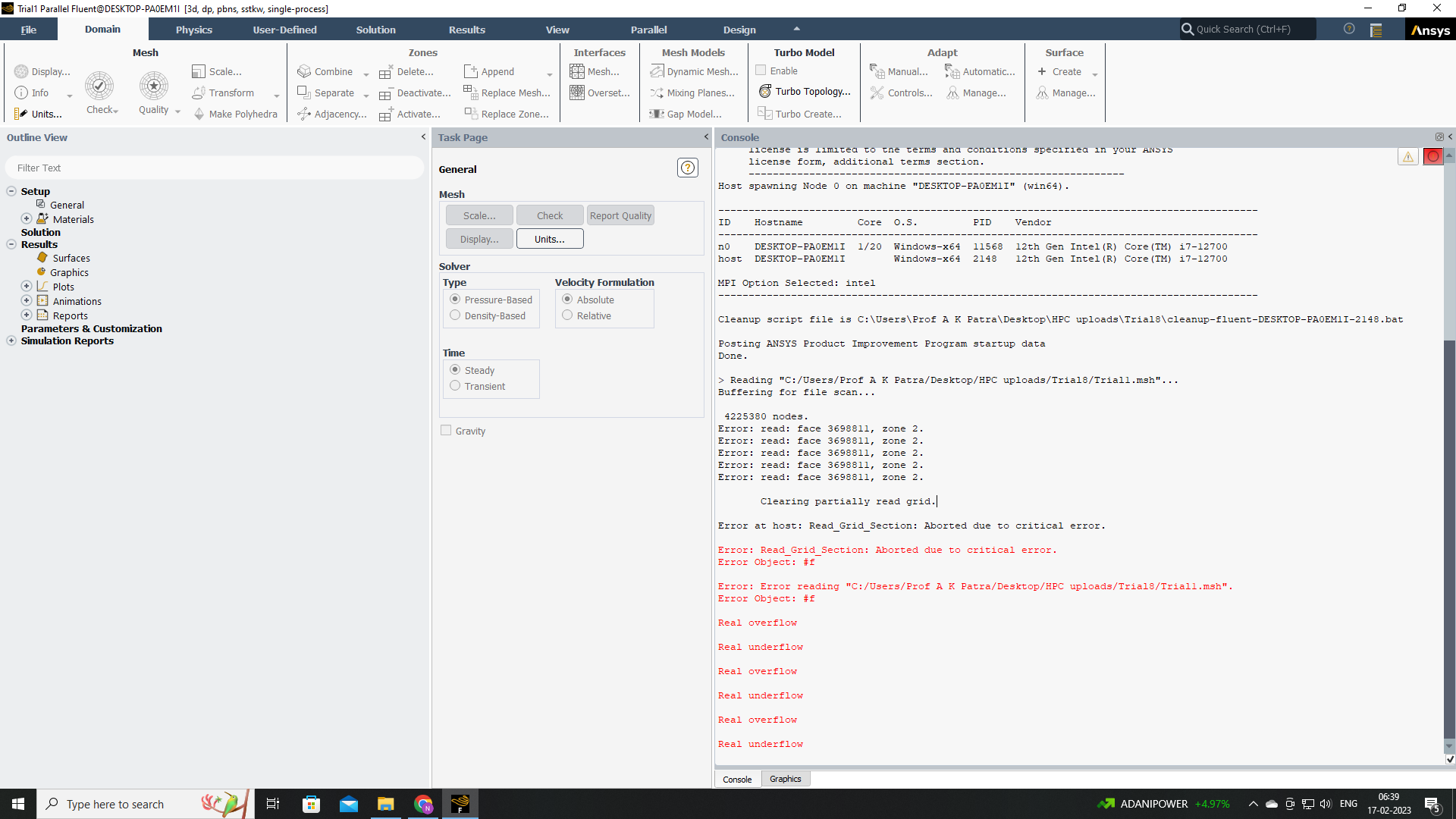

    • Ramesh Chandra Mishra
      The error starts in a similar fashion as posted in the screenshot above. Below screenshot contain ending lines though. Is there any chance this might be happening due to version incompatibility?
      So no hints immediately before the coordinates fail to load? Will Fluent Meshing read the file?

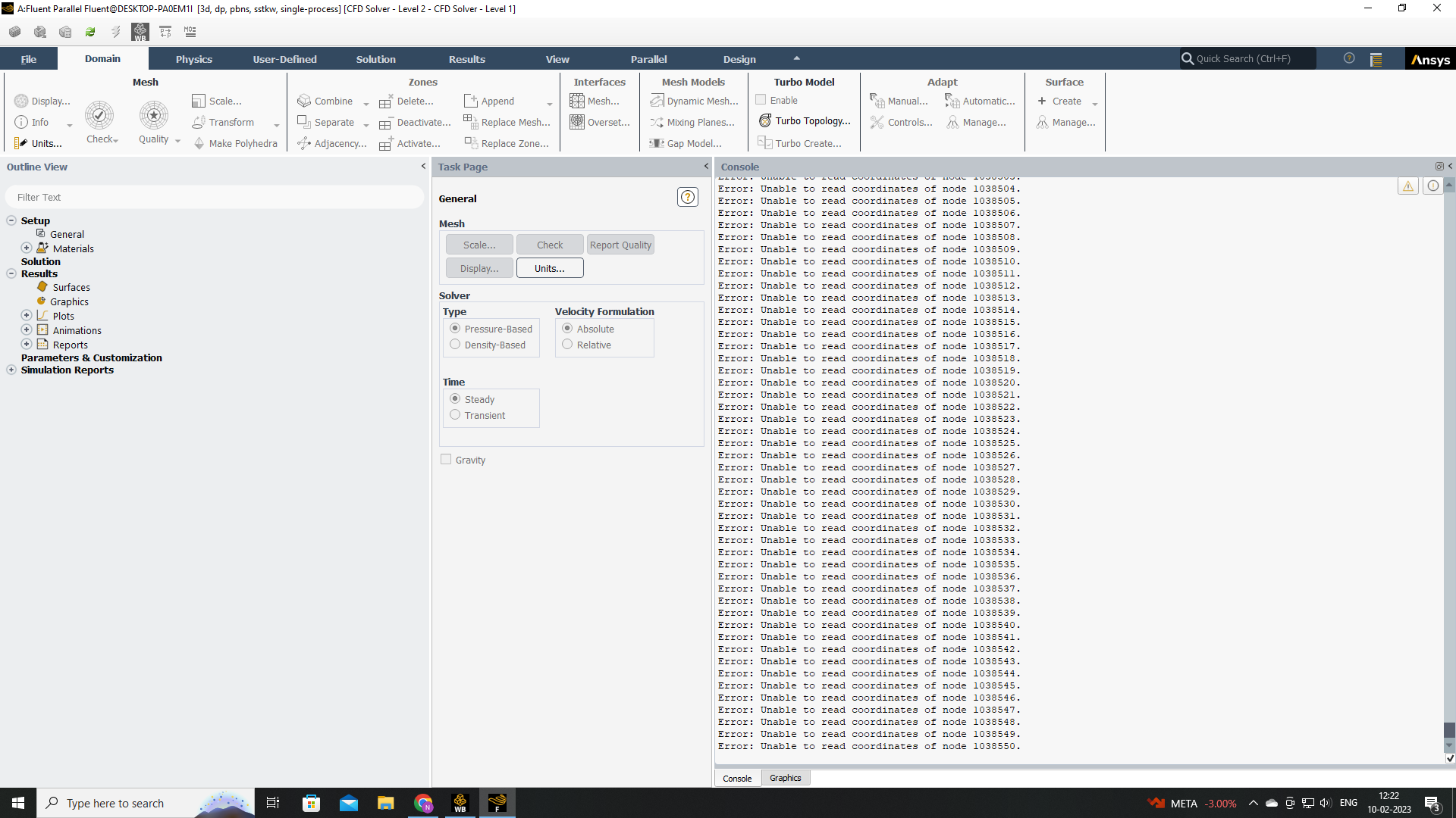

      Also, I made some changes to my mesh and now it gives the following errors. Can you please help me out with this.
      How much RAM have you got? Did the mesh pass the checks in Fluent Meshing?

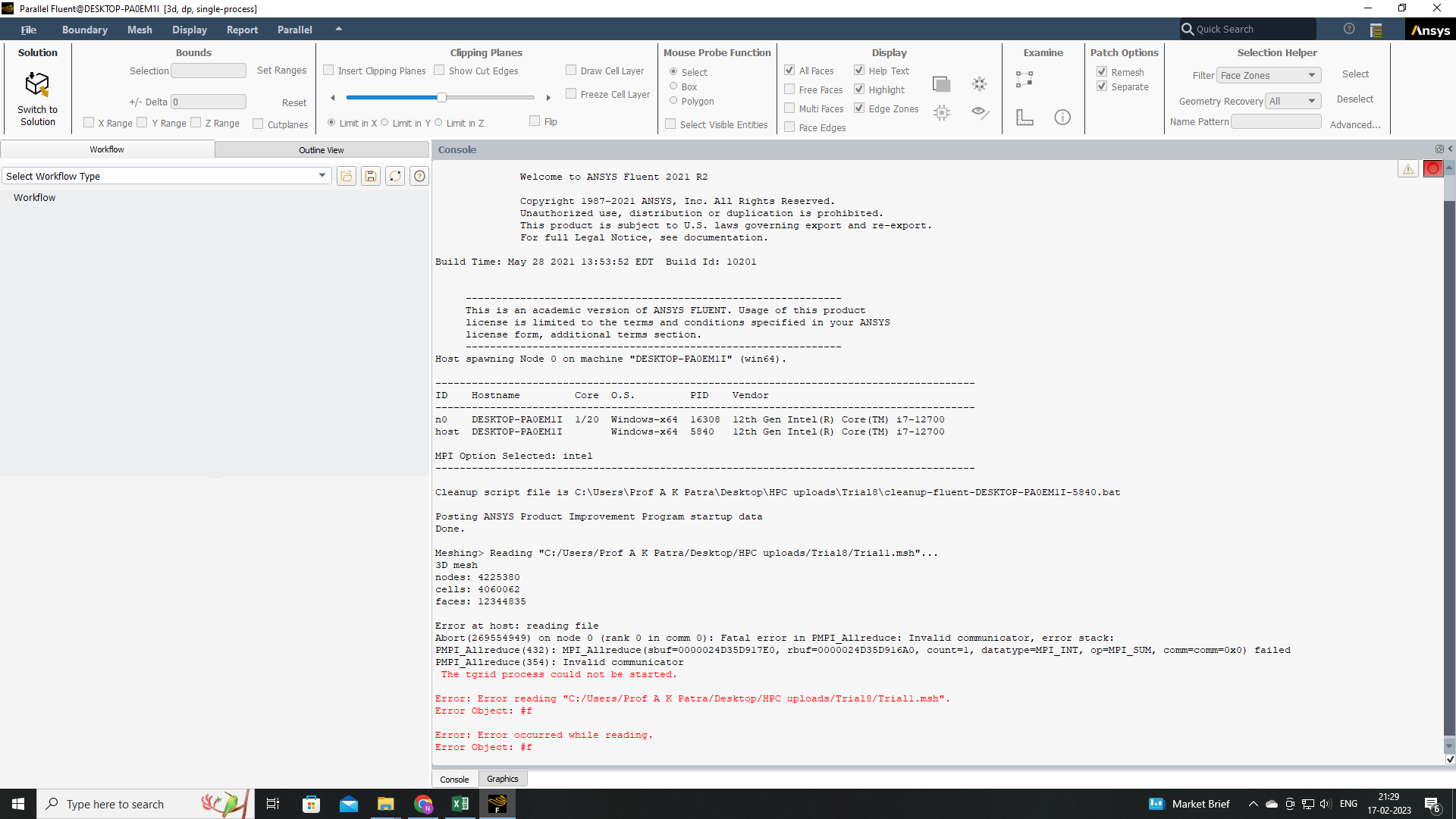

    • skadioglu
      Hi! I downloaded a simple mesh file from the learning hub tutorial. I could not open it in Fluent.
      I did not see an error message. Do you have any suggestions?

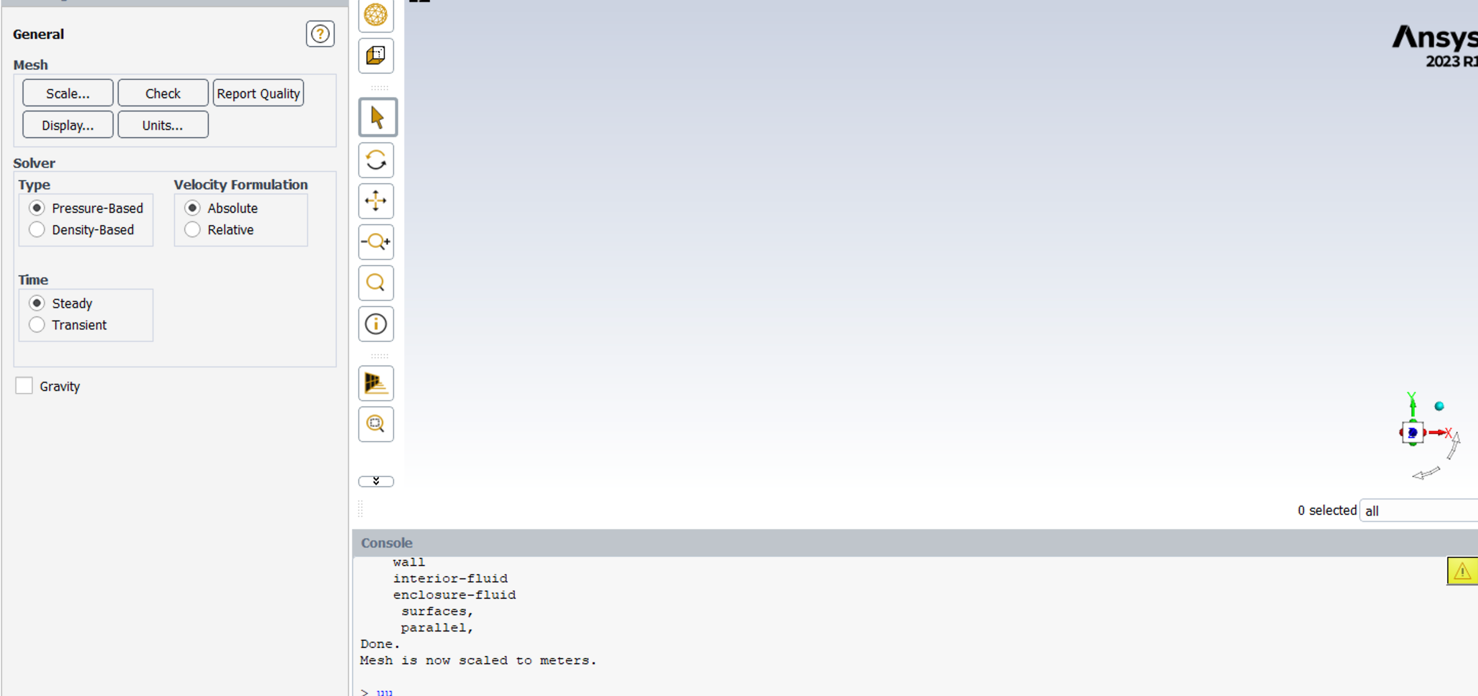

      Hi
      You can go to DISPLAY option on the left and click on edges and select the surfaces for which you want to see the mesh. Then click ok.
