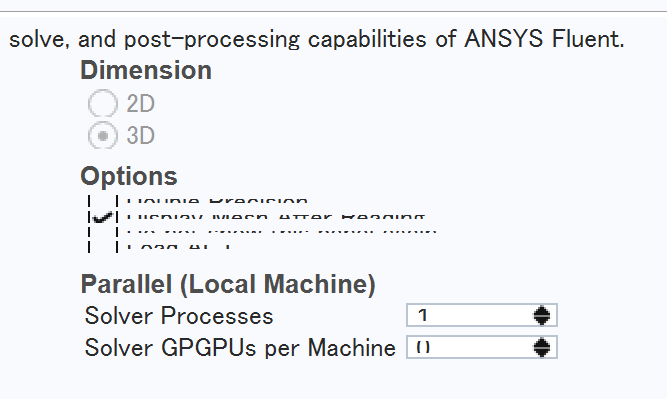

      As you can see in the attached image, the icon/font size in the Fluent app is way too large for my screen. Any help adjusting the icon/font size to a reasonable size would be greatly appreciated. I have tried the recommendations in this thread, which fixed the workbench resolution, but did not address the issue in Fluent. I tried adjusting DPI settings in the cx1950.exe, fluent launcher exe, and additional relevant extensions. Nothing has worked.

      As ANSYS Staff, we can not download attachments. Please insert images using insert image functionality.

    • davidsm
      Hi Keyur,
      Thanks for getting back to me. The image is re-attached. My screen resolution is correct for my laptop display and my preferences are set to default. I should note I'm using version 2019 R3, but this has been an issue with the past few versions. There should be a solution for either software version without changing my laptops screen resolution. Please let me know.

      The default layout is already selected. The issue is not my screen resolution. If I change my screen resolution so that the fluent icon size is normal, every other part of my display and other apps are minuscule, so that is not a valid solution. I have never had another app do this.
      I believe I am miscommunication my issue. When I first launched workbench, the icons were too small. To fix this, I followed the suggestion in this thread, which disabled display scaling. So the issue seems to be that workbench and fluent are scaling to my resolution incorrectly. Changing my resolution does not fix this, but instead, a setting in the app needs to be changed. However, I have been unable to find the correct setting or .exe file for fluent to make this change. I am hoping you can suggest the correct setting to change or point me in the right direction. Thanks again.
