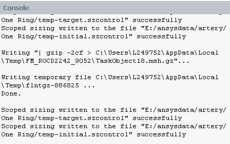

      After successfully generating a very simple Fault-tolerant mesh on some very simple geometry, I am now trying to apply it to more complex geometry.
      I click the Compute Size Fields button at the bottom and it seems to complete, but the item in the Workflow never advances to a green check mark and so the workflow has stalled.
      The console output looks like this...
      I right mouse button on the Compute Size Field(s) in the outline and select Update, and the same messages repeat in the Console, but still it does not go green check mark.

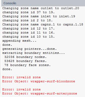

      I made a copy of the geometry and started over in 2019 R2.  I got further, and the workflow is a little different and the units are now in mm.
      Under Describe Geometry and Flow, I selected Internal Flow and answered Yes to Would you like to create large caps.  I see there is a mesh outside the region of interest, which is the small block at the bottom.  This mesh was generated in the Generate the Surface Mesh step.
      The console ended with these error messages:
      But in the Update Region Settings section, I selected surface mesh as the Extraction Method, so why does the error refer to a wrapper?
      Please advise.
      The dirty workflow is still being worked on, so it may be working better in R3.  If you are using that approach I think it still uses the wrapper somewhere to seal the volume. If you leave the workflow and look in the tree can you see any issues?

      Okay, I ran Fluent standalone, and I recognized a mistake I made in the first try. I didn't set the regions to void when I initially created the pipe and valve regions. When I did that, I got a complete workflow.
      I'm not claiming this is a good mesh, I just wanted to get a clean run through the workflow.

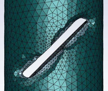

      Looks good. A bit more refinement and time should reduce the amount the valve gets chewed up, and inlet/outlet shouldn't get inflation (not watched the whole video so not sure why it did). Please can you add this to the Tutorials section?
      Okay, I got a good mesh around the top of the valve in the Tutorial video.
