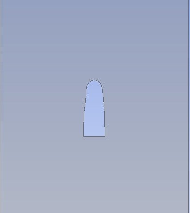

June 26, 2023 at 1:30 pm

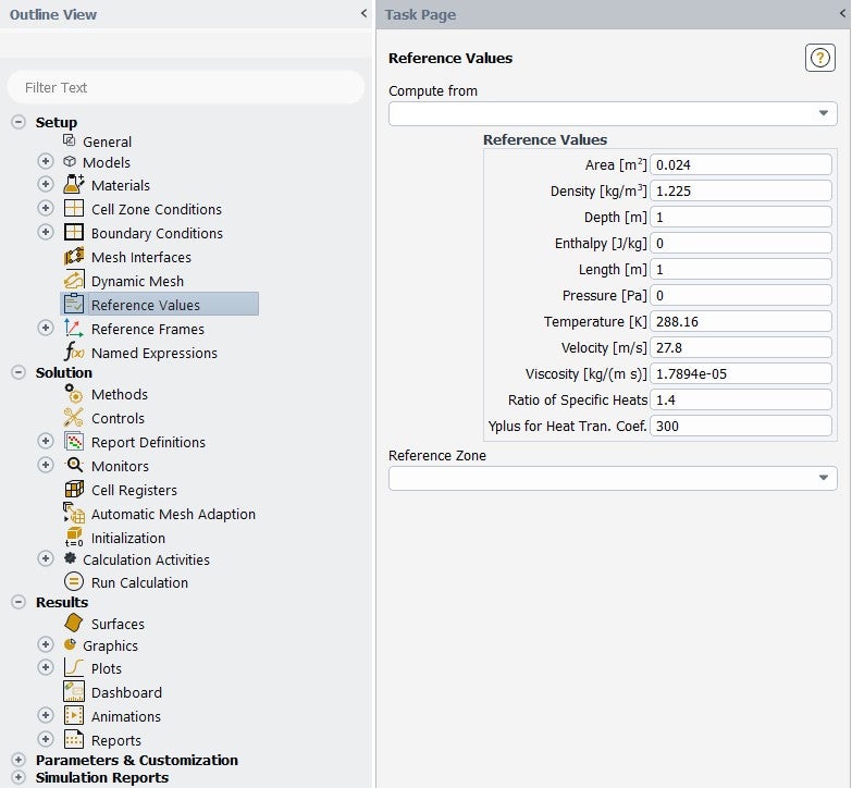

Conan Butler
This is the "cone" I used. My solving mode is set on planar, so it isn't axisymmetric. I could have made it axis-symmetric, but I didn't. What Area must I use for the "reference values" in fluent, which are used in the drag calculations? And I used the shell plane of the 3d version of this cone for its area, but I have to make sure first of all that is correct and second if the Drag CD is valid for the 3d cone or just for the 2d plane, which is visible in the picture above? This is the reference value tab:
June 26, 2023 at 1:59 pm
Rob
Forum ModeratorIf it's 2d planar it's not a cone, so you'll struggle to get a surface area for the coefficients to match a cone. The reference values are explained in the various air/aero foil tutorials (NACA for example).Â
June 26, 2023 at 2:56 pm
Conan Butler
SubscriberI understand what the reference values are. That's also not the problem.
Maybe let's formulate my question differently: what will you choose for the Area I have to fill in for the reference value for this shape (is it the area of the 2d cone sketch? etc)? And let's say, assuming looking at the "cone picture" the height is in the y direction and width in the x direction. The velocity is coming from the negative y direction towards the cone. And I want to know what the drag will be on the cone with these assumptions.
Again mentioning that the problem is not the not understanding of the drag etc. it's just what I assume the Area to be. And since this is not an Airfoil just using the chord length times the height isn't valid.
June 26, 2023 at 3:43 pm
Rob
Forum ModeratorCoefficients are always an odd one: the forces are just read from the pressure/shear results. As it's a coefficient the area you need is based on whatever you're comparing with: ie how did you compute the coefficient from the experiment. However, they are convenient and often used inside Fluent for the particle drag laws.Â
More usefully, Google of "drag coefficient formula cones" (lose the quotes) has a decent article from Aerospaceweb.org which seems fairly comphrensive. Â
