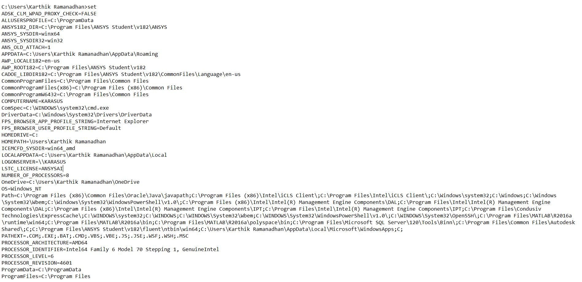

      Please post the screenshots of the following:

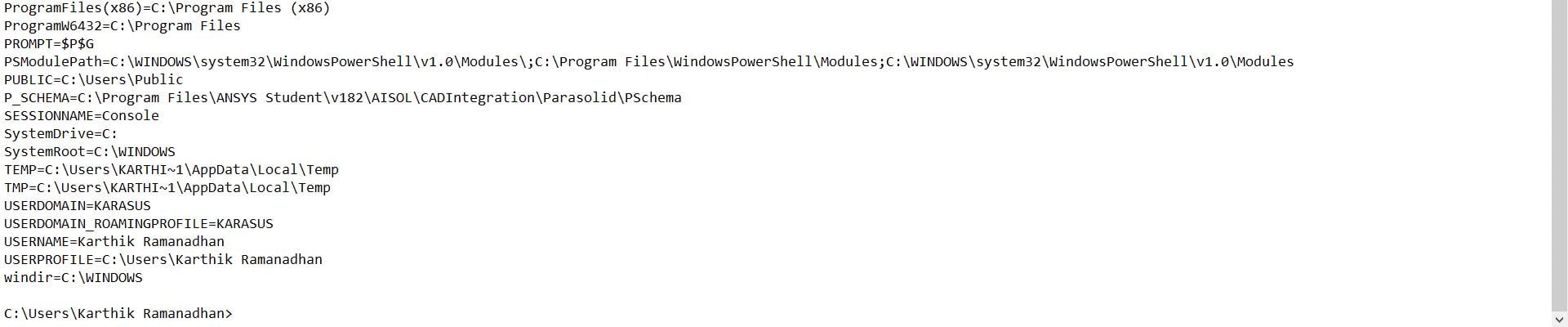

      - Open CMD Prompt, then type 'set' (without quote)

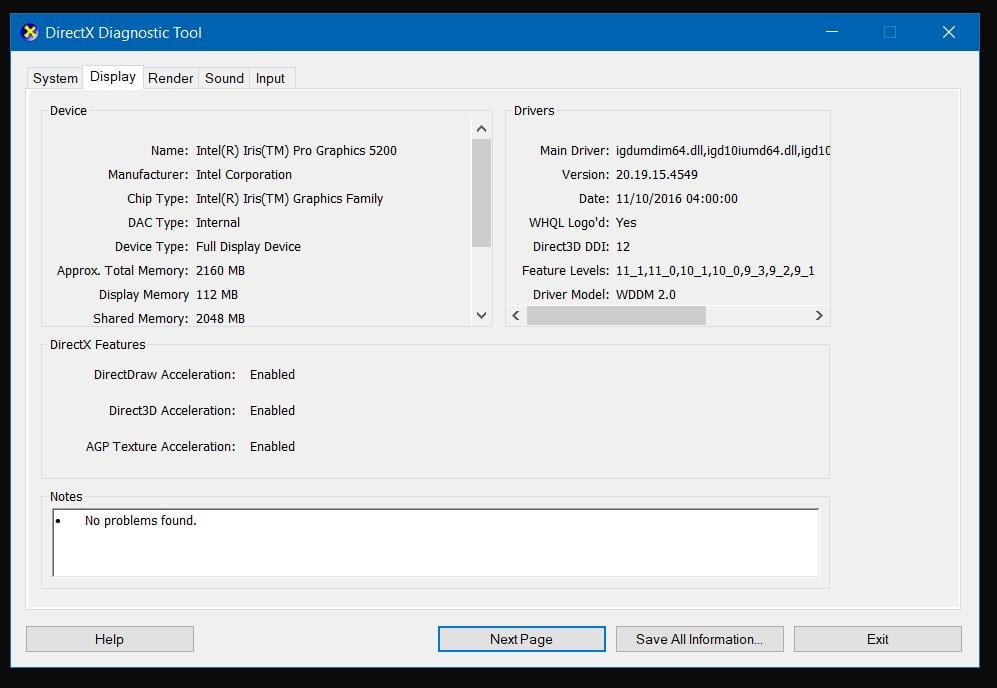

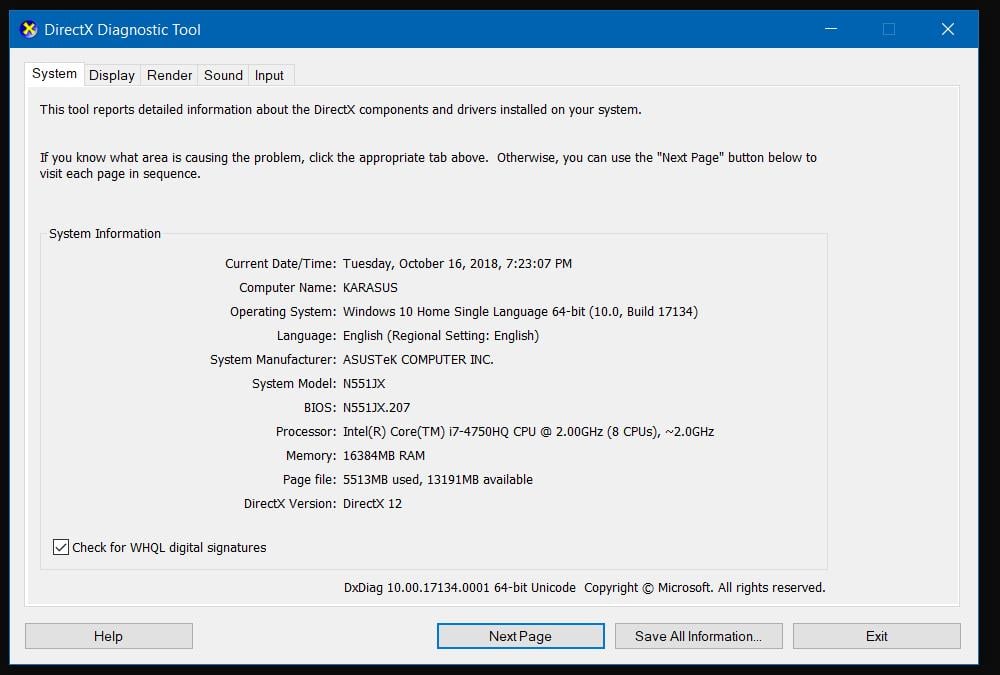

      - Open CMD Prompt, then type 'dxdiag'(without quote) , post screenshots of the first page and the tab that says 'Display'

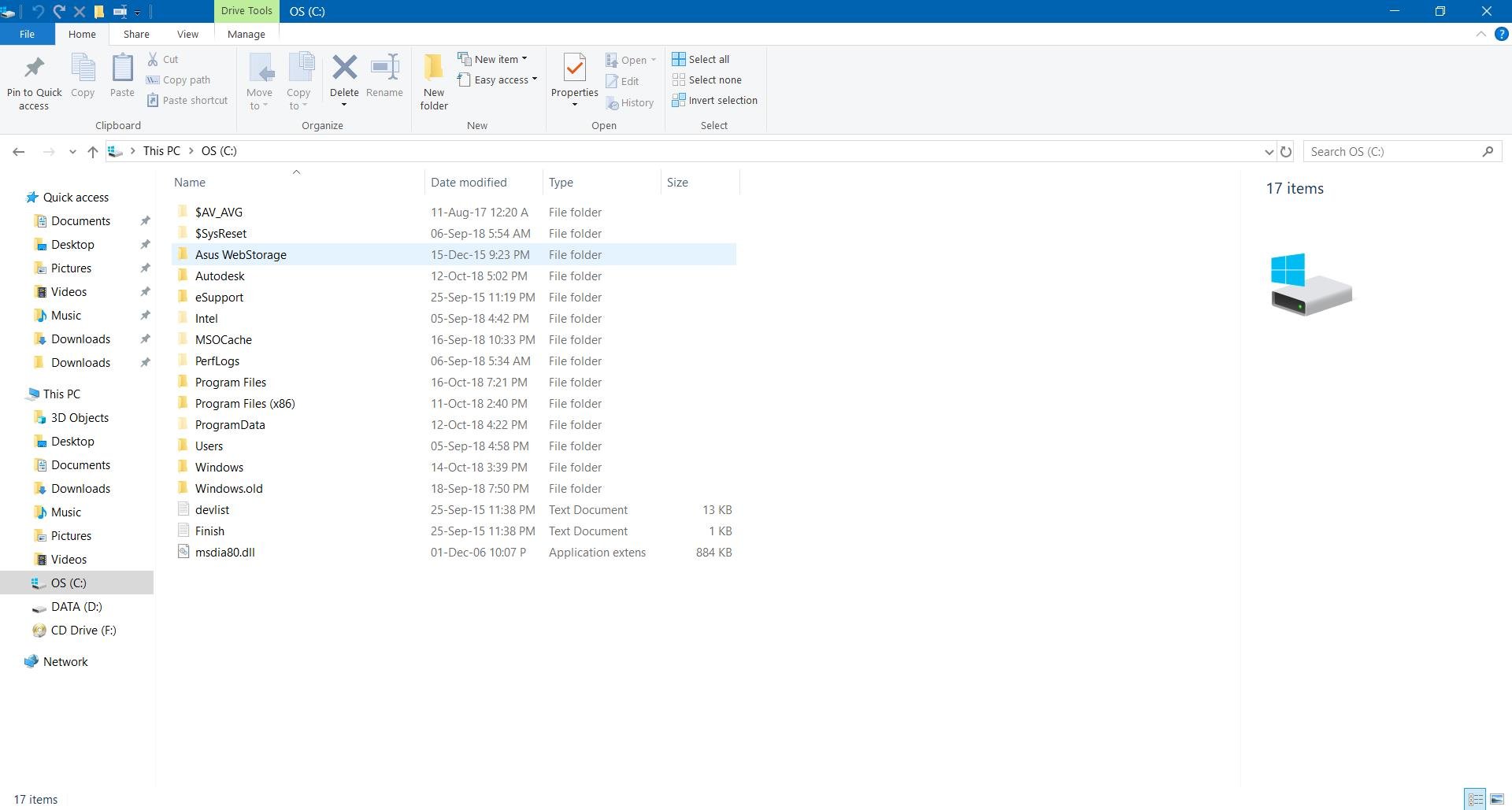

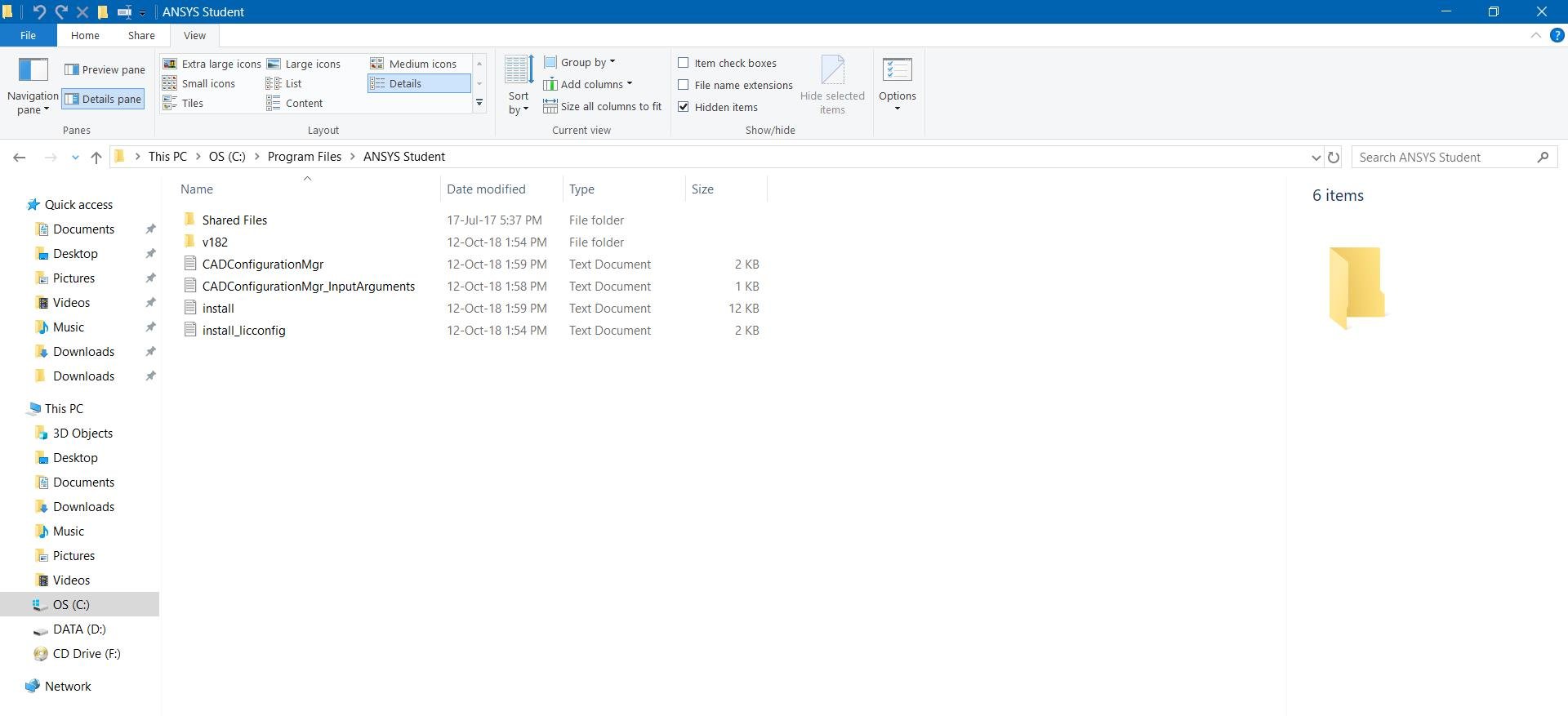

      - Open Windows File Explorer and browse to the drive where ANSYS is installed on (e.g., if it's installed under C:Program FilesANSYS IncANSYS Student , just browse to C:) , then make sure you can see all hidden files, and take the screenshot of the content of this drive.

      -CMD 'set' text file here
      -Dxdiag screens
       First page
      Display tab

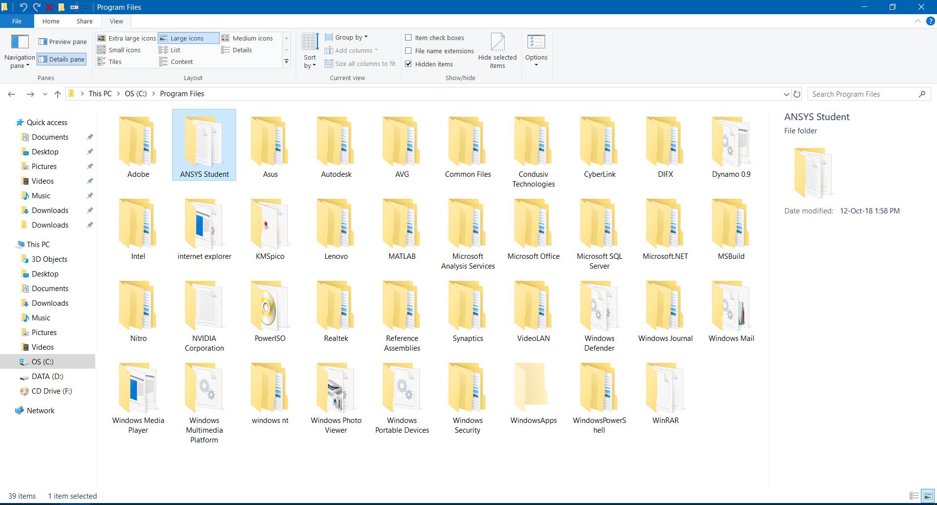

      -Installation Folders Screens
      -----C drive with "Show hidden"
      Cdrive will no hidden
      ----Ansys Student folder
      As per what you had suggested earlier, Ansys still works only with cmd prompt for me. The launcher constantly hangs.

      The link to download the text file for 'set' output is blocked from our network. Could you post the content here ?
      For the screenshot of the C drive, can you go up one level from C:Program Files to show the content of C:

    • karthik.ramanadhan
    • tsiriaks
      Hi karthik.ramanadhan,
      Thanks for the info.
      Can you try rearranging the value order of your Path environment variable ?
      The current order is something like this
      C:Program Files(x86)Common FilesOracleJavajavapath;C:Program Files (x86)InteliCLS Client;C:Program FilesInteliCLS Client;C:Windowssystem32;C:Windows;C:Windowssystem32Wbem;C:Windowssystem32WindowsPowerShellv1.0;..........
      I would like to try moving those that start with C:Windows to be at the front, so it would be something like this
      C:Windowssystem32;C:Windows;C:Windowssystem32Wbem;C:Windowssystem32WindowsPowerShellv1.0;C:Program Files(x86)Common FilesOracleJavajavapath;C:Program Files (x86)InteliCLS Client;C:Program FilesInteliCLS Client;..........
      But before making change to the value of the environment variable, please make sure you backup the current value into some text editor application like notepad, words, etc.
      Thanks you so much. This worked.
