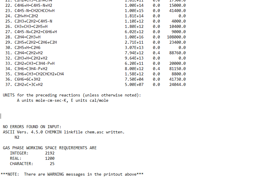

Thank you for replying to my question. Fluent crashes at run time after the first few iterations.Â
I checked the output file to check and there were no errors in it. Please see the attached screenshot of the output file.
I was not able to find the specific file that you had mentioned but I was able to find a similar file named, grimech30_thermo.dat and when I replaced C properties in my thermo file using that file, Fluent still crashed same as before.
I went ahead and found C(s) properties from the 'Chemkin Thermodynamic Database' from https://www.osti.gov/servlets/purl/7073290 and tried to replace that in my file and it still did not make a difference. Fluent crashed after the first few iterations again.Â

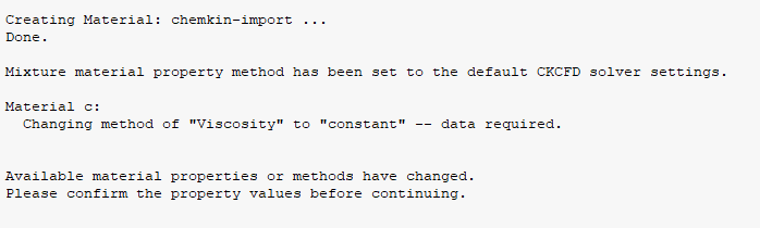

One thing noticed was whenever I import the chemkin files, Fluent gives the warning:Â
Do you think this might be the culprit? If not, do you have any other ideas that I can look into?

That error does not usually cause a problem. Can you please show me the output from the Fluent window? Please restart the run and include a screenshot of everything that happens from the before the start of the first iteration.
If you know when the crash is going to happen, you can also try stopping one iteration earlier and writing out a solution file. Post processing the results for species mnass fractions and temperature may also give some clues.
