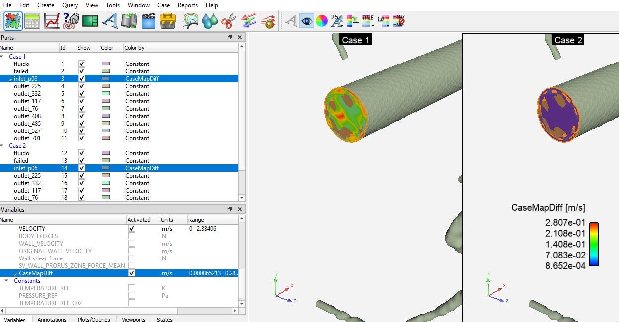

      I am trying the DiffMap function of Ensight for comparison of two fluent cases.
      I am reading two .cas .dat files( the mesh is polyhedra). The visualization is showing some "holes" in the colors for the inlet.
      Anyone can show a way of avoiding that holes ?
      Any comment is very welcome.
    • Rahul Kumar
      May I know which version you are using? Try with the latest 2023R1 release.
      Also, are performing the casemap based on a part or the entire case? Try mapping with the entire case.
      If the issue still persists, I would suggest to create a clip plane very close to the inlet and casemap.
