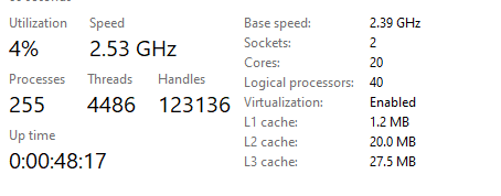

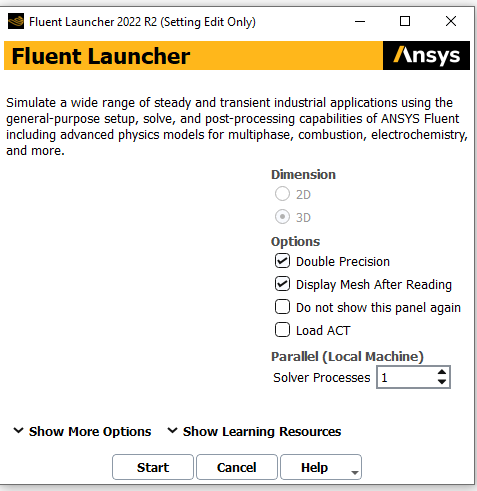

      Recently, I have updated my workstation to new one, with high number of processor. I have following issue, when I run the same model in the 2019 R3, it give the option for the serial and paraller as processing option. Generally, I go for the serial. When I tired to run the same model in the 2022 R2 with the following processing option: Then I am encountering the above error "Fluent Application failed to validate the connection".
      When I googled, I show the two solution, I am bit confuse if they are right or wrong:
      A. /forum/forums/topic/the-fluent-application-failed-to-validate-the-connection-what-to-do/ : To Rename C:\Windows\system32\libmdd.dll (e.g. to libmdd.dll.old) may resolve the issue. I am not the adminstrator of the workstation. Also I am not able to find that file.
      B. To reduce the numner of the solver: https://www.reddit.com/r/ANSYS/comments/vieo79/the_fluent_application_failed_to_validate_the/ : I think In that case, I should have some number of solver in the block but it only shows the "solver process as 1" should I change it to 4 or 8 or with 40 logical processors:

      Maybe checking the "Show More Options - pre/post ~~" would be helpful

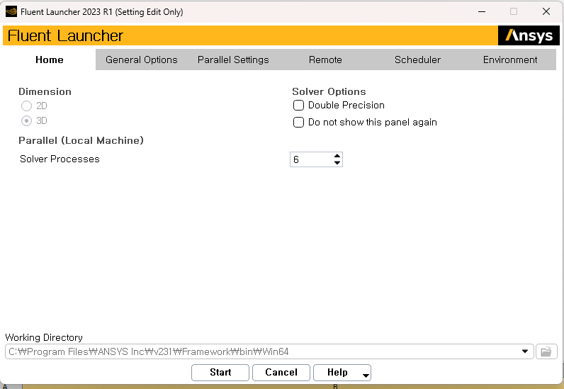

      • Dana Kang
        Hi Armando, may I ask you how you changed your file path?
        I’m having the same problem and for some reason Fluent doesn’t let me change the working directory.
