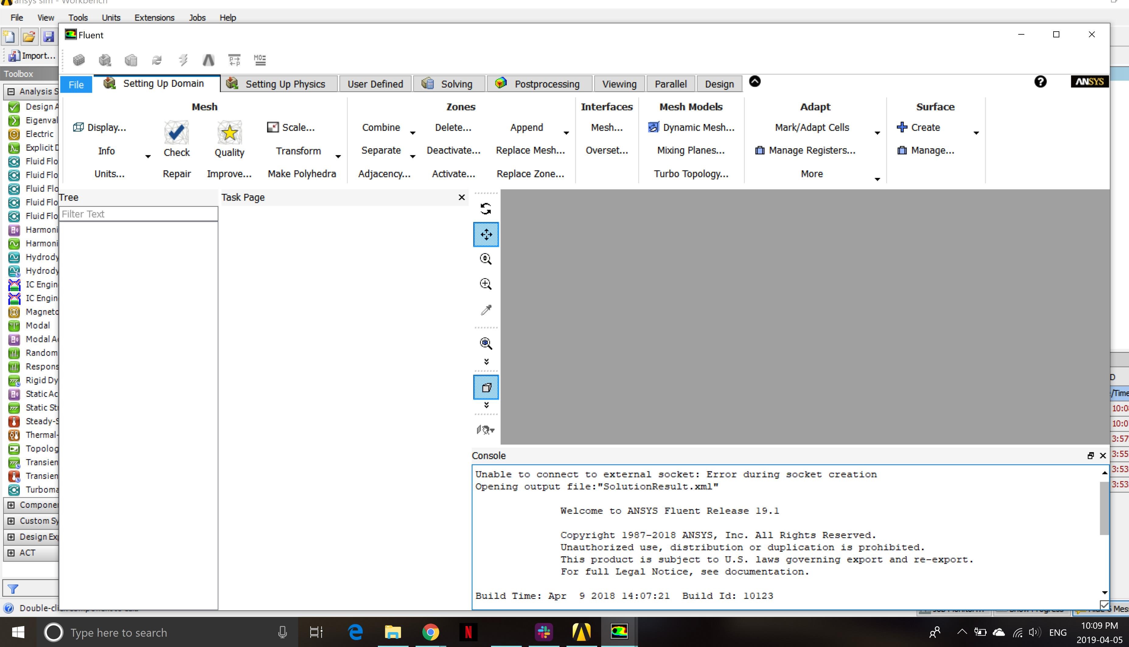

      When i try to open fluent within workbench it fails with the prompt fluent application fails to start. when i try to open fluent by itself it opens but never really loads.

      If you look at the console text output, this is now a different issue. It can now go farther but Fluent is still not completely launched , so the screen is still grey.
      Try launching it with this mode
      Processing Options : Parallel
      Processes : 0
      Does this help ?

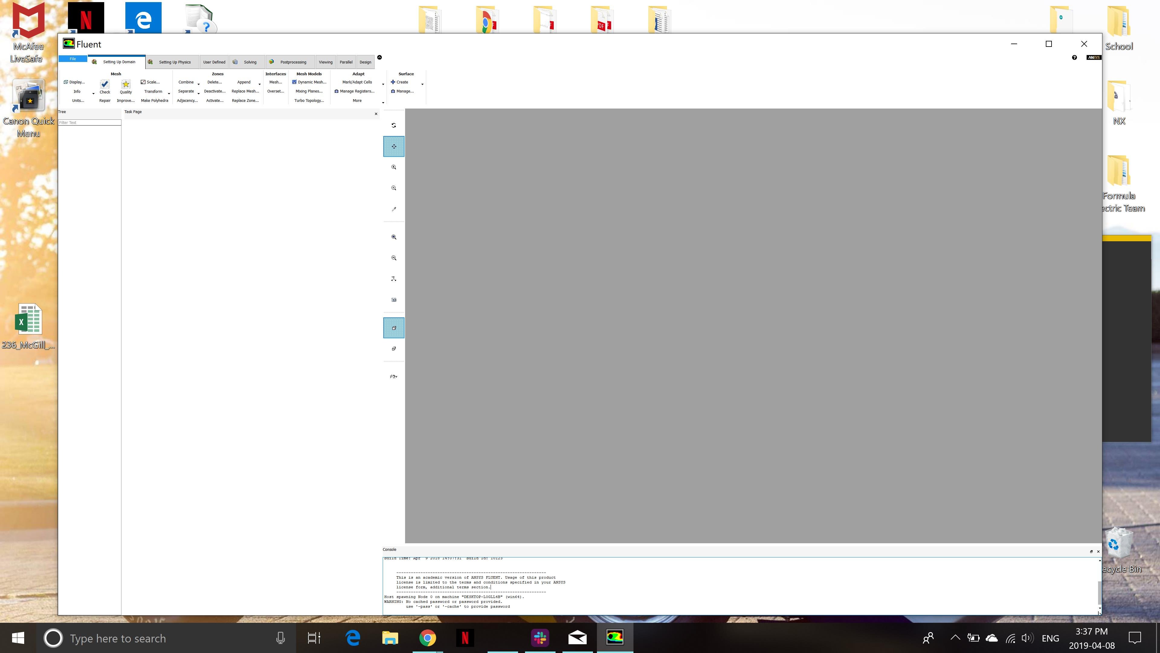

    • Reece99
      fluent opened fully when i ran it parallel. Here is the command prompt
    • Reece99
      When i try to run it in workbench it opens and then the second i try to do anything it fails

    • Reece99
      From what I could tell it appeared as though fluent opened and fully loaded, but once i tried to do anything the program crashed.

      Your issue with Workbench-Fluent is because of that error "unable to connect to external socket, error during socket creation" . This is likely because Firewall or Anti-virus software on the machine is blocking this.

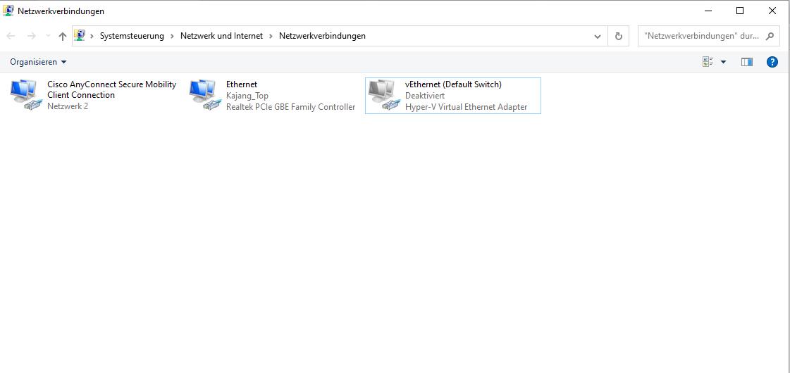

      Hallo everyone, I faced this same problem for past two weeks and finally solved it.
      My Fluent keep pointing the error " Fluent application failed to start".
      and in the Fluent log box says "Unable to connect to external socket: Error during socket creation Opening output fil".
      Based on this I assumed there is a connection failure between a Host and client.
      My set Up is a Client Side on Windows 10 with a VPN (Cisco) where i am receiving the license for Anysy from my university.
      I did everything as mentioned turning off firewall, reinstalling as admin, reconfiguring my VPn. but neither was working.
      Solution
      In the end , i traced back the problem to my Hyper-V Virtual Adapter Ethernet. If you are a Android Studio developer most probably you have this one too.
      Deactiavte it as i showed in this image. After that restart the pc and all error will not show again.
