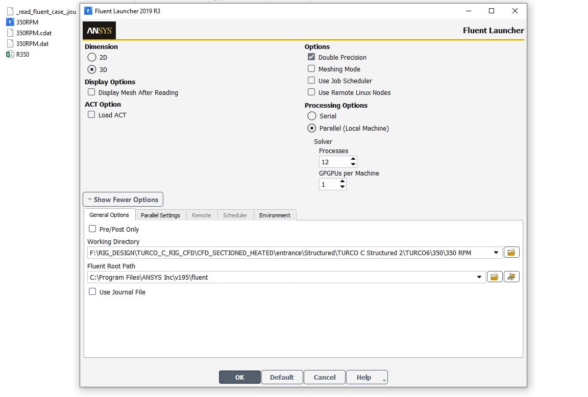

I have just updated ANSYS to 2019 R3. First, Fluent did not show up under ANSYS apps, I had to dig into the directory to find the Fluent.Then, I launched it, it was all fine. Oddly, Fluent did not import the case when I clicked on the case file. Fluent was launched but the case was not imported. If I explicitly import the case -file>read>case, it's fine but a bit annoying.
Any idea why this is happening?
Thanks.

Ansys Employeeyou can use "C:Program FilesANSYS Incv195fluentntbinwin64fluent.exe"
where did you click on case file? in starting window?
can you please insert any images.

Thanks for your reply. Yes, I used that directory to find fluent which I could launch with no issue whatsoever. However, when I start the fluent by clicking one of the previously saved case file (*.cas), it throws me some errors -unbound variable, and does not load the case file. I have to then go to file>read case file which I think is a bit annoying.
Please see below for the console text, and attachments for the pics. (Sorry for posting separately, they did not go through in one post)
Thanks

SubscriberError: eval: unbound variable
Error Object: f:rig_designturco_c_rig_cfdcfd_sectioned_heatedentrancestructuredturco
Error Object: c
Error Object: structured
Error Object: 2turco6350350
Error Object: rpm350rpm.cas

SubscriberMPI Option Selected: ibmmpi
Selected system interconnect: default
Cleanup script file is F:RIG_DESIGNTURCO_C_RIG_CFDCFD_SECTIONED_HEATEDentranceStructuredTURCO C Structured 2TURCO6350350 RPMcleanup-fluent-engs-******.bat

Forum ModeratorTry with a file that doesn't have a space in the name and/or folder structure.Â
March 4, 2020 at 3:52 pm
heisenmech
SubscriberHi rwoolhou ,
Just tried, still no luck. Same error and no case file is imported.
Error Object: f:rig_designturco_c_rig_cfdcfd_sectioned_heatedentrancestructuredtest_section_structured500500_rpm500rpm.cas
