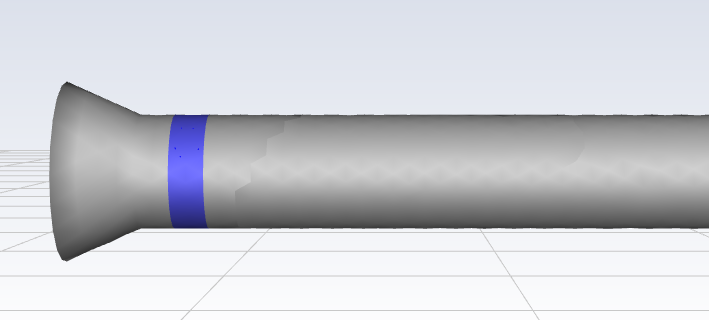

February 20, 2024 at 5:32 pm
ibrahimallam087
SubscriberÂ
im trying to make here a sort of ventilated cavityÂ
February 20, 2024 at 5:29 pm
ibrahimallam087
SubscriberÂ
here is my problem the water enter from main inlet with velocity of 6 m/s and exit as outlet pressureÂ
and there as a mass flow outlet from the cylinder as indicated with 0.0005 kg/s airÂ
the problem is the air doesnt enter the domainÂÂ
February 20, 2024 at 5:31 pm
ibrahimallam087
Subscriberim trying to vary the intlet of the cylinder as velocity inlet with negative values or pressure inlet but still there is no air entring the domain from cylinder at all
February 21, 2024 at 9:25 am
Rob
Forum ModeratorThe cylinder would have a normal velocity of 6m/s or x-magnitude of -6m/s can you confirm? Also, VOF velocity inlets must be all of one or other phase, so you'd have a velocity inlet for the water and pressure outlet at the other end.Â
February 21, 2024 at 11:32 am
ibrahimallam087
Subscriberthe cylinder has an inlet to the enclsure with mass flow rate of 0.0005 kg/s (Air),Another inlet to the enclosure is water as indicated with velocity of 6m/s normal to the boundary,the outlet is outlet pressure type with gauge pressure 40000pascal
February 21, 2024 at 11:38 am
ibrahimallam087
Subscriber -
February 21, 2024 at 11:56 am
Rob
Forum ModeratorOK, and at that flow rate do you expect to form a film, or small bubbles? Have you patched in a layer of gas adjacent to the inlet?Â
February 21, 2024 at 1:33 pm
ibrahimallam087
Subscriberno i didnt patch gas , i just expect it to make cavity of air inside water to reduce drag of the cylinder
February 21, 2024 at 1:40 pm
Rob
Forum ModeratorTry patching a layer of gas, but also check you have sufficient mesh to resolve the film or bubbles. About 10 cells across the bubbles or film ought to do it: aspect ratio as near to 1 as possible.Â
