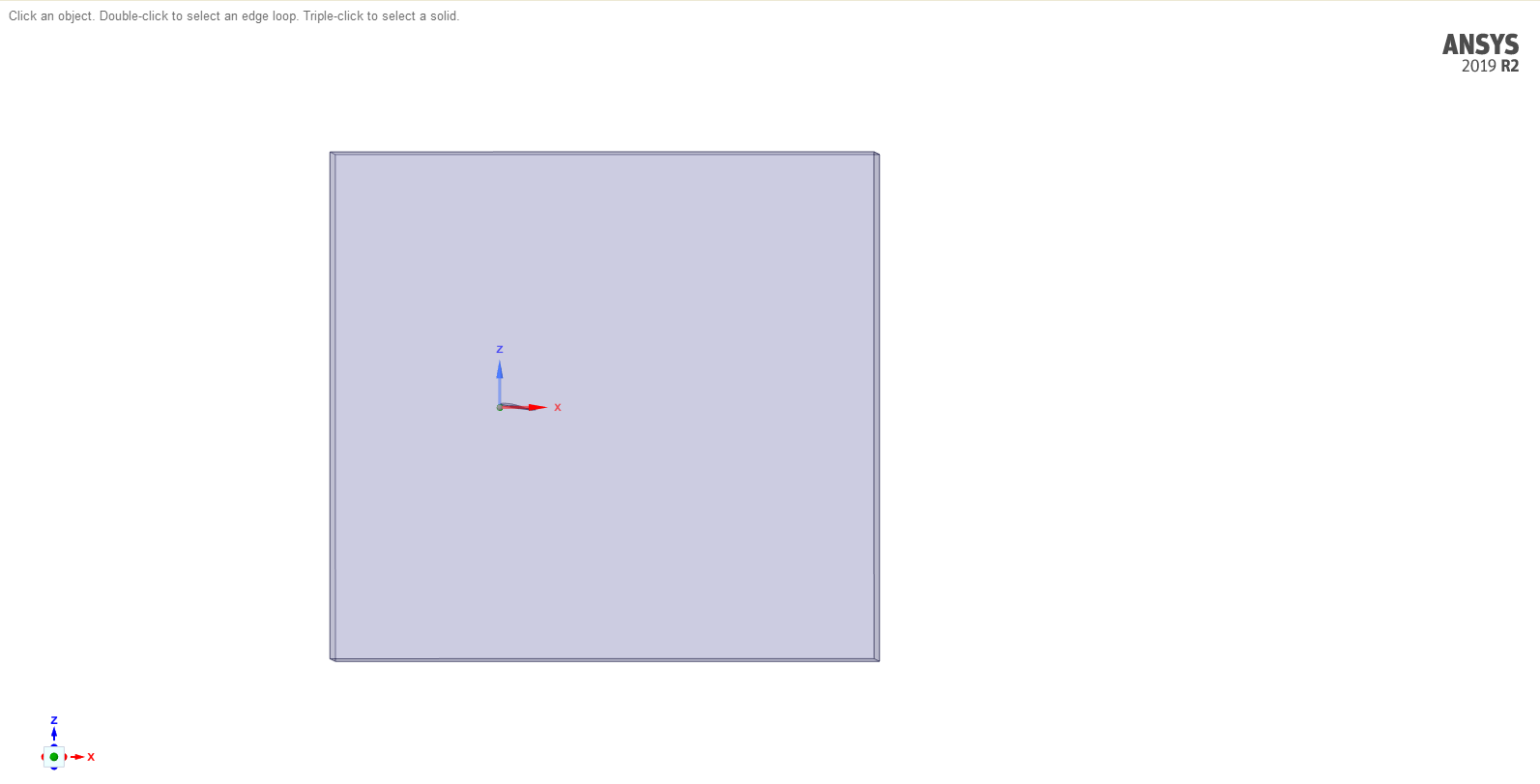

Ansys EmployeeWho are we? I use the natural boundary conditions which are for this case pressure outlets. Here one need to be careful to place the sides far away from the BOI. Wall or symmetry boundary conditions are a sort of simplifications. Using Wall only if there are real walls at that real distance from the BOI.nAugust 10, 2020 at 6:49 amIbrahimabdullah
