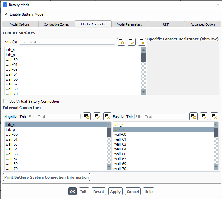

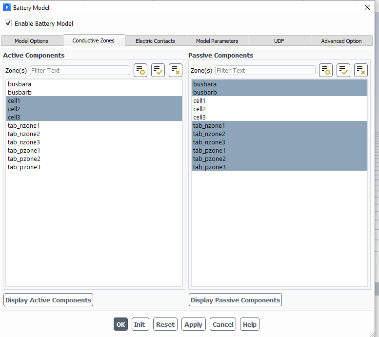

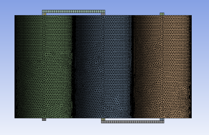

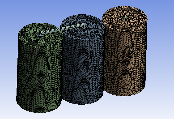

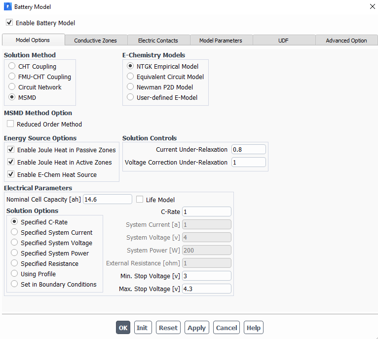

      I am currently trying to get a small cylindrical cell battery pack working using the MSMD battery model, for which I have followed the procedures from the fluent manual and a youtube tutorial in terms of the named components (tabs, bus bars etc.). Here is the mesh (roughly 400k elements):
      The average skewness is 0.22, and the average orthogonality is 0.77, which I understand are acceptable values.
      In fluent after setting up the MSMD model and successfully initialising, I get the following floating point exception error when running the calculation, which after doing some research this seems like it could be the result of almost anything.
      Error at Node 0: floating point exception
      Stabilizing uds-0 to enhance linear solver robustness.
      Stabilizing uds-0 using GMRES to enhance linear solver robustness.
      Divergence detected in AMG solver: uds-0 Stabilizing uds-1 to enhance linear solver robustness.
      Error at host: floating point exception
      ===============Message from the Cortex Process================================
      Compute processes interrupted. Processing can be resumed.
      Error: floating point exception
      Error Object: #f
      Grateful for any assistance as to how to fix this, please let me know if more info is required.

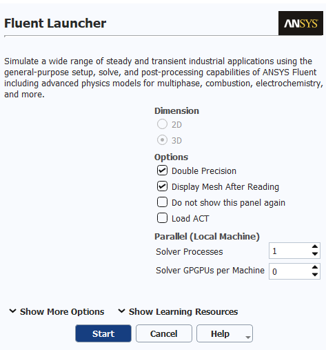

    • ali.abbas
      check if double precision is enabled
      • rl517
        This appears to have fixed it, the calculation runs now. Thank you so much!
