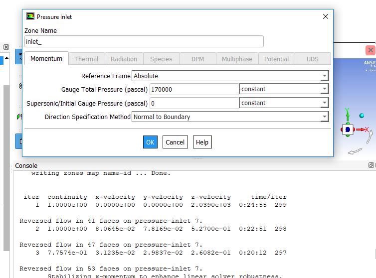

      i am simulating concrete in a 3d pipe with length 38.50m and dia 0.125m.
      this error occurs when i give inlet B:C as VElocity inlet or pressure inlet but it didnot occur when i give mass flow inlet B:C
        iter continuity x-velocity y-velocity z-velocity time/iter
      3 7.5377e-01 3.1057e-02 3.1086e-02 2.6119e-01 0:10:48 500
      reversed flow in 114 faces on pressure-outlet 6.
      Stabilizing x-momentum to enhance linear solver robustness.
      Divergence detected in AMG solver: x-momentum Stabilizing y-momentum to enhance linear solver robustness.
      Divergence detected in AMG solver: y-momentum Stabilizing z-momentum to enhance linear solver robustness.
      Divergence detected in AMG solver: z-momentum Stabilizing pressure correction to enhance linear solver robustness.
      Divergence detected in AMG solver: pressure correction
      Error at host: floating point exception
      Error at Node 0: floating point exception

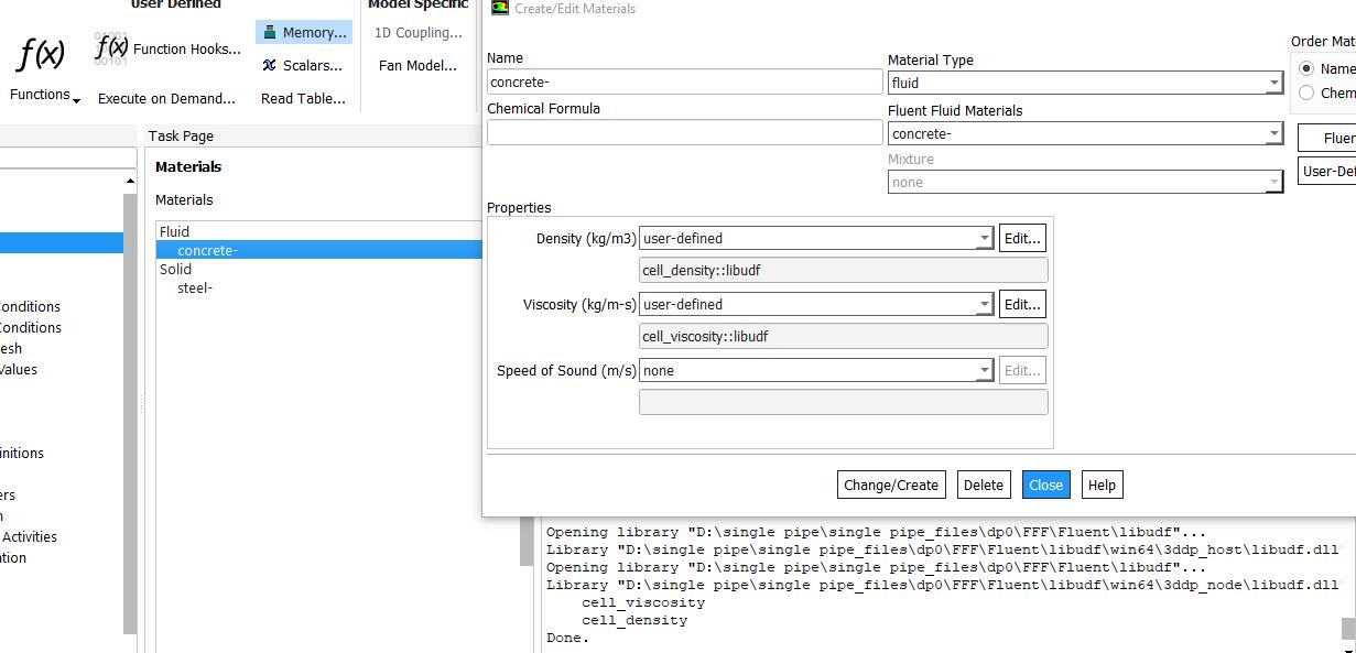

      i am using laminar model. Viscosity and density is defined by udf file.

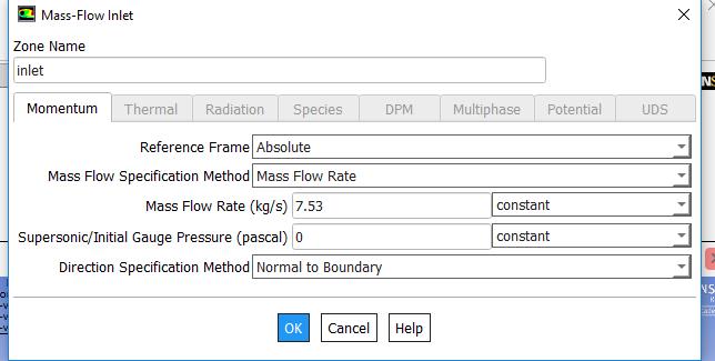

      boundary coditions
      inlet mass flow
      outlet pressure outlet.i have attched screen short as well

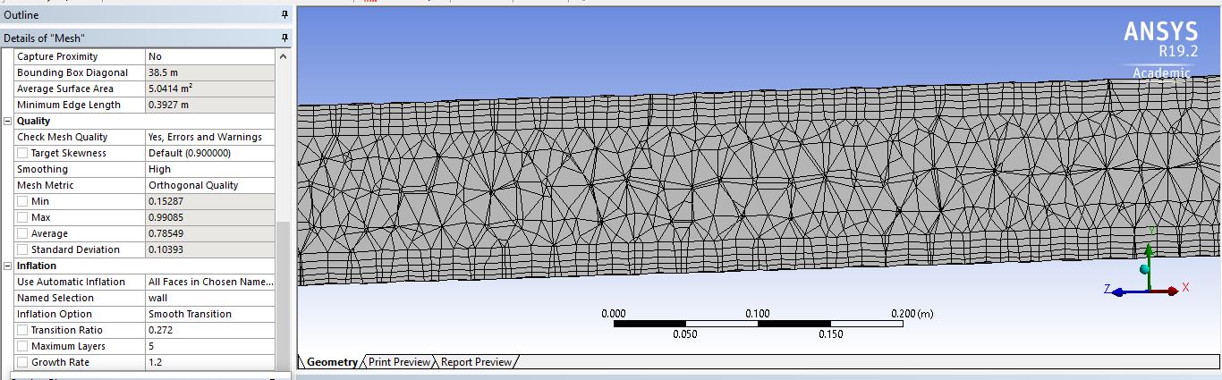

      meshing details

      saying that, i can see there is some jump in the mesh from fine to coarse. can you please make sure that mesh is smooth.
      also what is min orthogonal quality of mesh? it should be above 0.1.

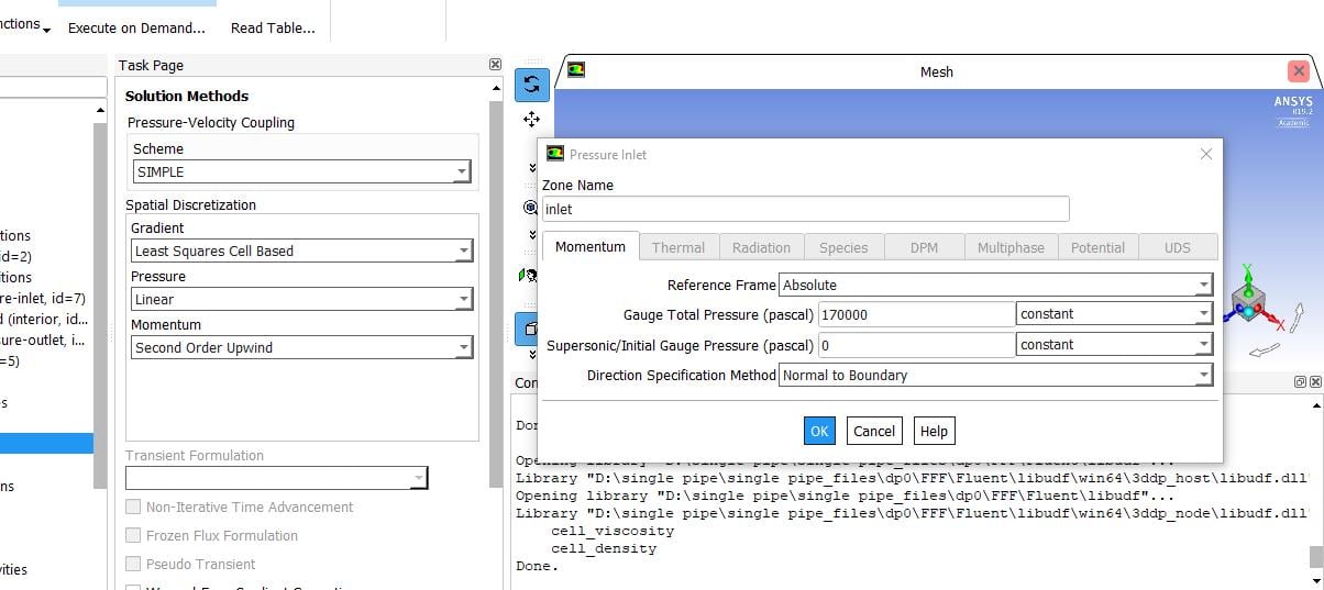

      Dear KKanade,
      I have make some changes in my meshing quality, but the problem is sam ewhen i give pressure inlet B.C or Velocity inlet condition.
      i Attached my udf file and meshing detail again.

      If you're using a Bingham viscosity model why are you setting viscosity based on location? The UDF is working (otherwise it'd not run at all) so I'd start looking at viscosity etc just before the model fails: it's almost certainly due to an excessively high value or gradient.
    • Malik
      could you please explained, i did not understand.
      while i am using viscosity udf file so i am not taking harshel balkely model.
      i assume that it will take into account by reading the file.
