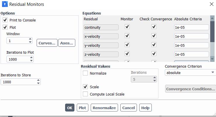

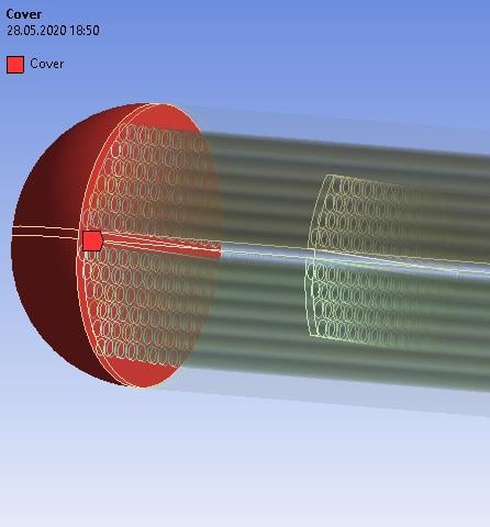

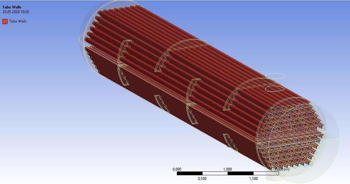

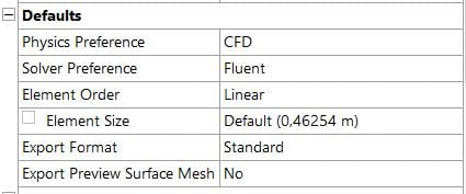

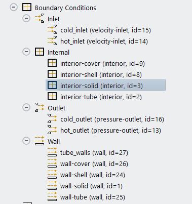

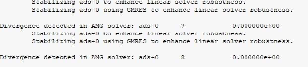

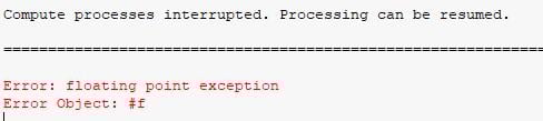

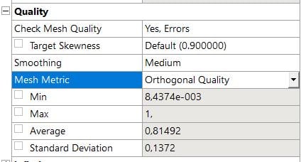

      So i am currently trying to make CFD analysis for my heat exchanger model but when i try to initalize i am getting Floating object exception and Error object: #f errors on FLUENT. I am posting the screenshots about my work including named selections of model. By the way i need to say that i had to delete contact regions because i was getting contact region errors. I need to complete my analysis as soon as possible so i will be very happy if i can solve this issue. Thanks.
    • Wallace
      I need to add something. When i enabled adaptive meshing i was able to get results and did not get any errors. But when i enable adaptive meshing my cylindirical tubes becomes hexagonal. I also tried body sizing for mesh while adaptive meshing was enabled but i got floating point excpetion error again. I will be pretty happy if you can help me.

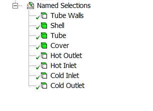

      Btw i changed my named selections and they look like this right now.

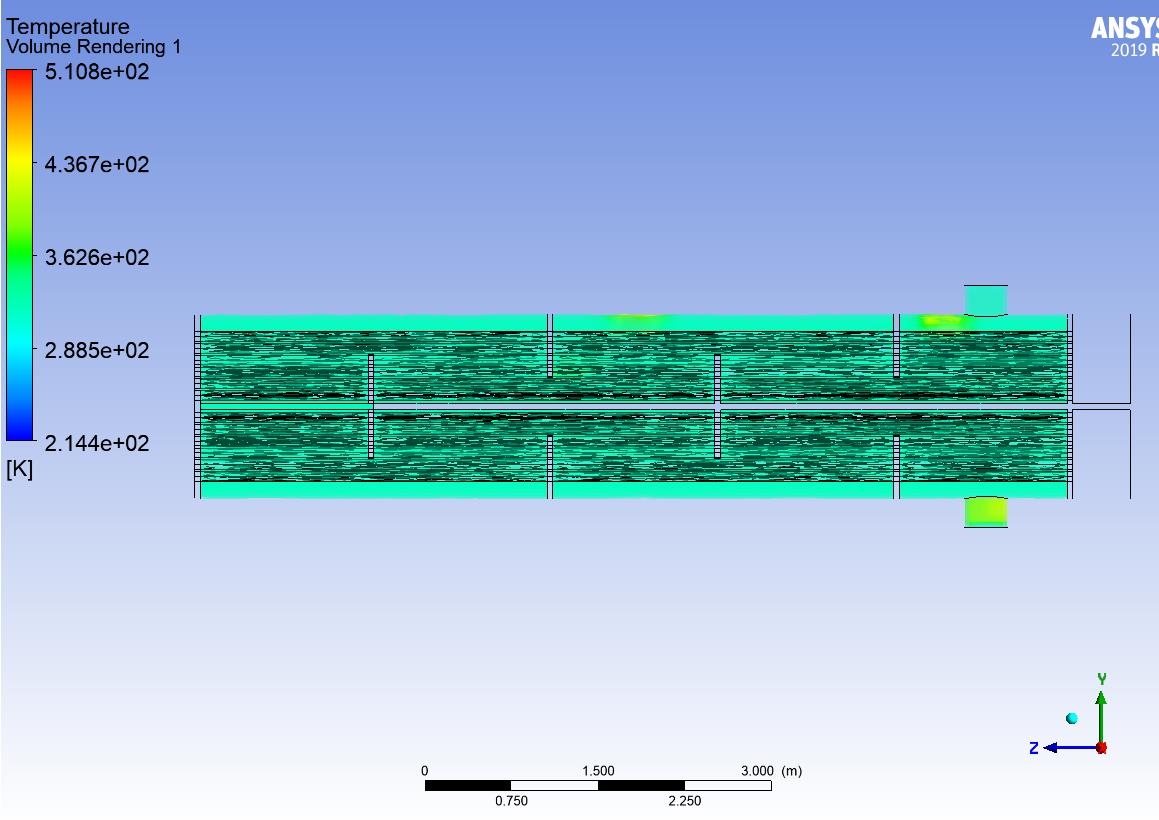

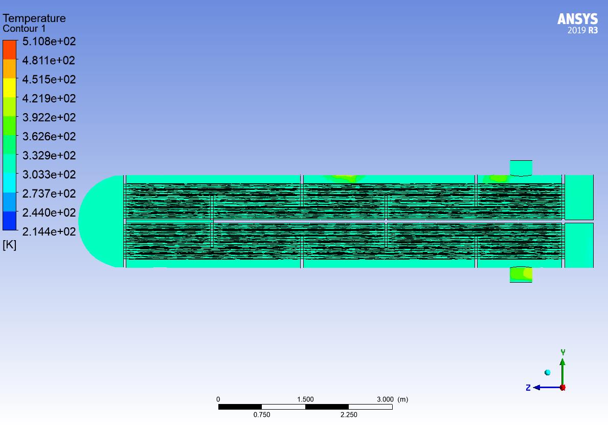

      These are how my results looking when adaptive meshing is enabled(hexagonal tubes) for 20 and 50 celsius inlets.

      It is likely that you are dealing with a mesh quality issue. Based on the screenshots you've provided, it seems like you have a poor mesh (min orthogonal quality < 0.1 and Max skewness > 0.9). I'd strongly recommend that you improve your mesh quality before you run your simulation. The floating-point error you are seeing is because Fluent is unable to converge your solution.
