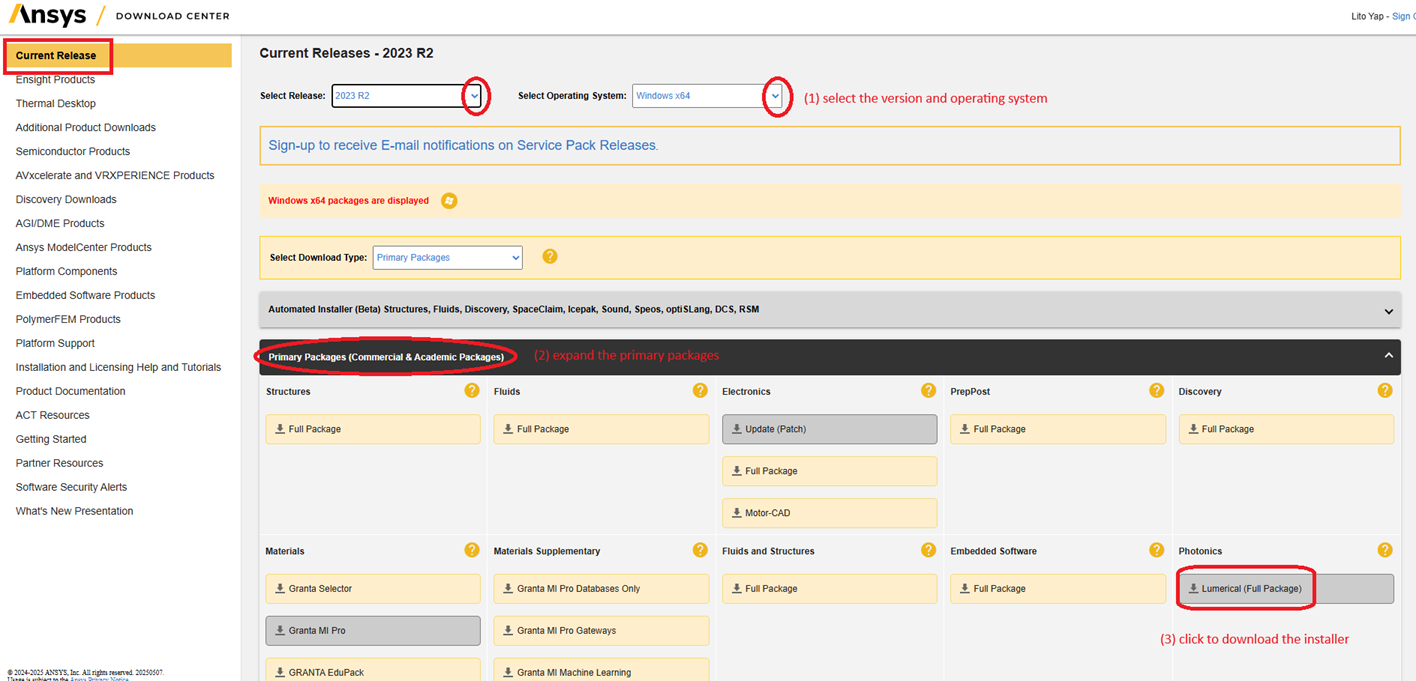

      Since your TECS/subscription expired recently, try to run Lumerical 2023 R2 on the client machines. Lumerical 2023 R2 installer is available in the Ansys Customer Portal - downloads page.
