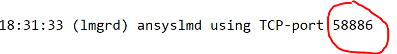

Another question I have is regarding ports. Once the server has been restarted a port that we have allowed has changed and now needs to be opened which we have done.
Is there a way of making this static. With other Flex licensing you are able to add "port = _____" somewhere in the license file to make this always use said port.
January 25, 2023 at 7:36 am
ANSYS_MMadore
Forum ModeratorYou can set ansyslmd to a static port by adding it in the license file on the VENDOR line.
