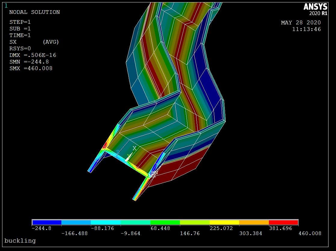

SubscriberI want to use inistate command to give initial stresses. The initial stresses are due to welding and cutting and i have the distribution over the area but i am not able to give it to the model can some one help with how to give these stresses to the system i am using an I Section and i am using shell elements i also tried with beam elements but it did not work. I want to get the critical buckling load of a column with geometrical and material imperfections.

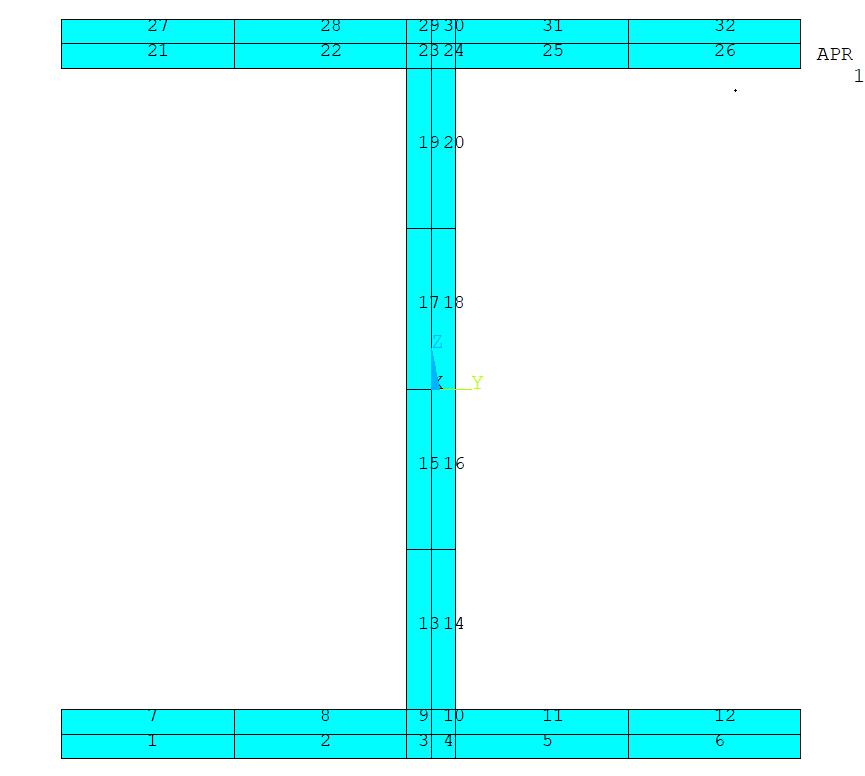

Subscriberhi,
i am using mechanical apdl but i am using the user interface of apdl only when i want to change something i use editor my first question is i have a i section and i have residual stresses distributed throughout the section i want to use beam elements 188 for non linear analysis
my question is for beam 188 inistate can be given to cells but i do not know how many cells are there in my i section how to find out how many cells i have in my i sectionÂ

Subscriberhi i have successfully used inistate command to get my critical buckling load but now i want to do the non linear analysis i have written a code for it can some one see why it is not converging and how to converge my non linear solutionÂ

Subscriber hi i am using arc length method but it is not converging can you please check my code and tell me what mistake i am doingÂ

!The procedure for inistate command must be like this:Â
! First set initial state datatype, you will implement stressÂ
inistate,set,dtype,stre ! here we tell the program we will implement stress data
! Then implement the initial stress to the cells of associated element.Â

May 28, 2020 at 9:28 am
May 28, 2020 at 9:30 am
May 28, 2020 at 1:52 pm
Wenlong
Ansys EmployeeOk, so you have a total of 32 cells. In your input, can you make the INISTATE stop at "inistate,define,i,,32,,-0,15*fy".
Also just making sure, did you correct your input to move /prep7 before /solu ?
Wenlong
May 28, 2020 at 2:57 pm
swasthik456
SubscriberhiÂ
no 32 cells was just an example as you asked me why i am doing it to 72 cells and how do i know where are these cells can you please do a small model run with two different residual stresses to get the buckling loads and check if they are the same or not as for me they are coming sameÂ

May 28, 2020 at 3:14 pm
Wenlong
Ansys EmployeeHi Prasanna,
I found the issue in your code, in your INISTATE, you accidently put 0.15*fy as 0,15*fy. After correcting it, the INISTATE works fine now. I attached a small test where I applied INISTATE, hold both ends of the beam and run, now you can see the beam deform under the initial stress, and the stress distribution at different cells.Â

fy = 600
*SET,nel,10
*do,i,1,nel ! loop over the elements (nel: number of elements).
inistate,define,i,,1,,+0.08*fy ! here you will input cell number and stress value with direction (sxx, syy etc.).
inistate,define,i,,2,,-0.408*fy
inistate,define,i,,3,,-0.408*fy
inistate,define,i,,4,,+0.9*fy
inistate,define,i,,5,,+0.9*fy
inistate,define,i,,6,,+0.9*fy
inistate,define,i,,7,,-0.408*fy
inistate,define,i,,8,,-0.408*fy
inistate,define,i,,9,,+0.08*fy
inistate,define,i,,10,,+0.08*fy
inistate,define,i,,11,,-0.408*fy
inistate,define,i,,12,,-0.408*fy
inistate,define,i,,13,,+0.9*fy
inistate,define,i,,14,,+0.9*fy
inistate,define,i,,15,,+0.9*fy
inistate,define,i,,16,,-0.408*fy
inistate,define,i,,17,,-0.408*fy
inistate,define,i,,18,,+0.08*fy
inistate,define,i,,19,,+0.08*fy
inistate,define,i,,20,,-0.408*fy
inistate,define,i,,21,,-0.408*fy
inistate,define,i,,22,,+0.9*fy
inistate,define,i,,23,,+0.9*fy
inistate,define,i,,24,,+0.9*fy
inistate,define,i,,25,,-0.408*fy
inistate,define,i,,26,,-0.408*fy
inistate,define,i,,27,,+0.08*fy
inistate,define,i,,28,,+0.9*fy
inistate,define,i,,29,,+0.9*fy
inistate,define,i,,30,,+0.9*fy
inistate,define,i,,31,,-0.15*fy
inistate,define,i,,32,,-0.15*fy
*enddo

Wenlong
May 28, 2020 at 7:09 pm
swasthik456
Subscriberthanks now my results are betterÂ
