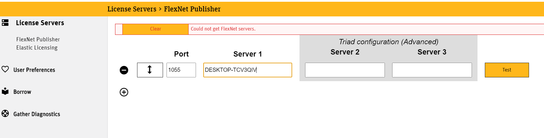

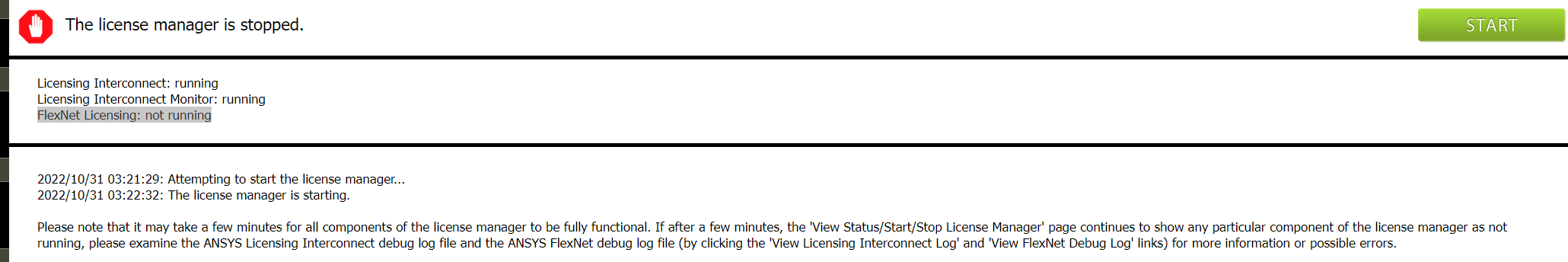

FlexNet Licensing: not running

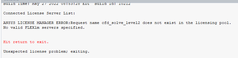

      2022/10/31 03:33:05    CACHE_SERVER        Available licenses from file E:\Ansys\ANSYS Inc\Shared Files\Licensing\license_files:

      2022/10/31 03:33:09    INFO                Still trying to start FLEXlm server. Please wait ...
      2022/10/31 03:33:19    INFO                Still trying to start FLEXlm server. Please wait ...
      2022/10/31 03:33:29    INFO                Still trying to start FLEXlm server. Please wait ...
      2022/10/31 03:33:39    INFO                Still trying to start FLEXlm server. Please wait ...
      2022/10/31 03:33:49    INFO                Still trying to start FLEXlm server. Please wait ...
      2022/10/31 03:33:59    INFO                Still trying to start FLEXlm server. Please wait ...
      2022/10/31 03:34:09    INFO                Still trying to start FLEXlm server. Please wait ...
      2022/10/31 03:34:19    INFO                Still trying to start FLEXlm server. Please wait ...
      2022/10/31 03:34:29    INFO                Still trying to start FLEXlm server. Please wait ...
      2022/10/31 03:34:39    INFO                Still trying to start FLEXlm server. Please wait ...
      2022/10/31 03:34:49    INFO                Still trying to start FLEXlm server. Please wait ...
      2022/10/31 03:34:59    INFO                Still trying to start FLEXlm server. Please wait ...
      2022/10/31 03:35:09    INFO                Still trying to start FLEXlm server. Please wait ...
      2022/10/31 03:35:19    INFO                Still trying to start FLEXlm server. Please wait ...
      2022/10/31 03:35:29    INFO                Still trying to start FLEXlm server. Please wait ...
      2022/10/31 03:35:39    INFO                Still trying to start FLEXlm server. Please wait ...
      2022/10/31 03:35:49    INFO                Still trying to start FLEXlm server. Please wait ...
      2022/10/31 03:35:59    INFO                Still trying to start FLEXlm server. Please wait ...
      2022/10/31 03:36:09    INFO                Still trying to start FLEXlm server. Please wait ...
      2022/10/31 03:36:19    INFO                Still trying to start FLEXlm server. Please wait ...
      2022/10/31 03:36:29    INFO                Still trying to start FLEXlm server. Please wait ...
      2022/10/31 03:36:39    INFO                Still trying to start FLEXlm server. Please wait ...
      2022/10/31 03:36:49    INFO                Still trying to start FLEXlm server. Please wait ...
      2022/10/31 03:36:59    INFO                Still trying to start FLEXlm server. Please wait ...
      2022/10/31 03:37:09    INFO                Still trying to start FLEXlm server. Please wait ...
      2022/10/31 03:37:19    INFO                Still trying to start FLEXlm server. Please wait ...
      2022/10/31 03:37:29    INFO                Still trying to start FLEXlm server. Please wait ...
      2022/10/31 03:37:39    INFO                Still trying to start FLEXlm server. Please wait ...
      2022/10/31 03:37:59    ERROR               Failed to start the FLEXlm license manager. Please check the FLEXlm log file E:\Ansys\ANSYS Inc\Shared Files\Licensing\license.log for more information (errno = 0).
      2022/10/31 03:37:59    ERROR               Could not start FLEXlm server. Please check the FLEXlm log file. Exiting.
      2022/10/31 03:37:59    INFO                Ready to accept connections.
      2022/10/31 03:38:00    INFO                FlexNet server ansyslmd has been started by an outside process.
      2022/10/31 03:38:00    INFO                Stopping FLEXlm server using path 1055@localhost
      2022/10/31 03:38:01    INFO                Stopped FLEXlm server.
      2022/10/31 03:38:01    INFO                Windows service stopped.

      I have the academic paid version from my university.
      I'm not sure what's wrong with the installation.
    • George Karnos
      From the message, it seems the license file doesn't start until November 1st.
      Can you try to stop and start the license server again and check if it starts?
      • Zhihao Liu
        Oh wow, that is the issue. The License manager is able to run with no problem. However, when I tried to run Ansys Fluent. It is still giving me errors.

    • George Karnos
      On the machine where you see the issue, run:
      Start->Ansys 2022 R2->Ansys Client Licensing Settings 2022
      Verify that the License server is listed. If Not add it and save.
    • Zhihao Liu
      I see, it solved the issue. Thank you so much!
