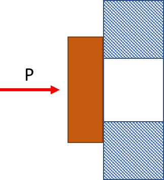

I am trying to set up a simulation to investigate deformation and stress on a tiny cylindrical part when pressed against a rigid reference, just like the picture below:
The rigid part (blue) has a hole in it, and the flexible one (orange) is a solid cylinder, so that the contact between both is a ring-area. I am performing a 3D analysis.
Initially, I had not modeled the blue part, and considered only the orange one with a defined ring-area on its back, to which I applied fixed support. That doesn't seem to work great, as the stresses in the support region are artificially high and would get higher as I refined the mesh.
Second approach was modeling the blue part, set it up as a rigid body and fix it with a body-ground joint. Then, I applied bonded contact between the parts (they will indeed be glued together eventually). The problem with the artificially high stresses seems to persist.
Lastly, I've set the contact as frictional. The max stress value has lowered, but I am still not sure what is the best way to proceed with this kind of simulation.
Could anyone please share some insights on how you would set it up?

The last approach is the most realistic I suppose (frictional contact) as it perhaps represents the real situation. Perhaps have all parts flexible as this is more realistic.
You can still get some high artificial stresses perhaps (say near contact areas).

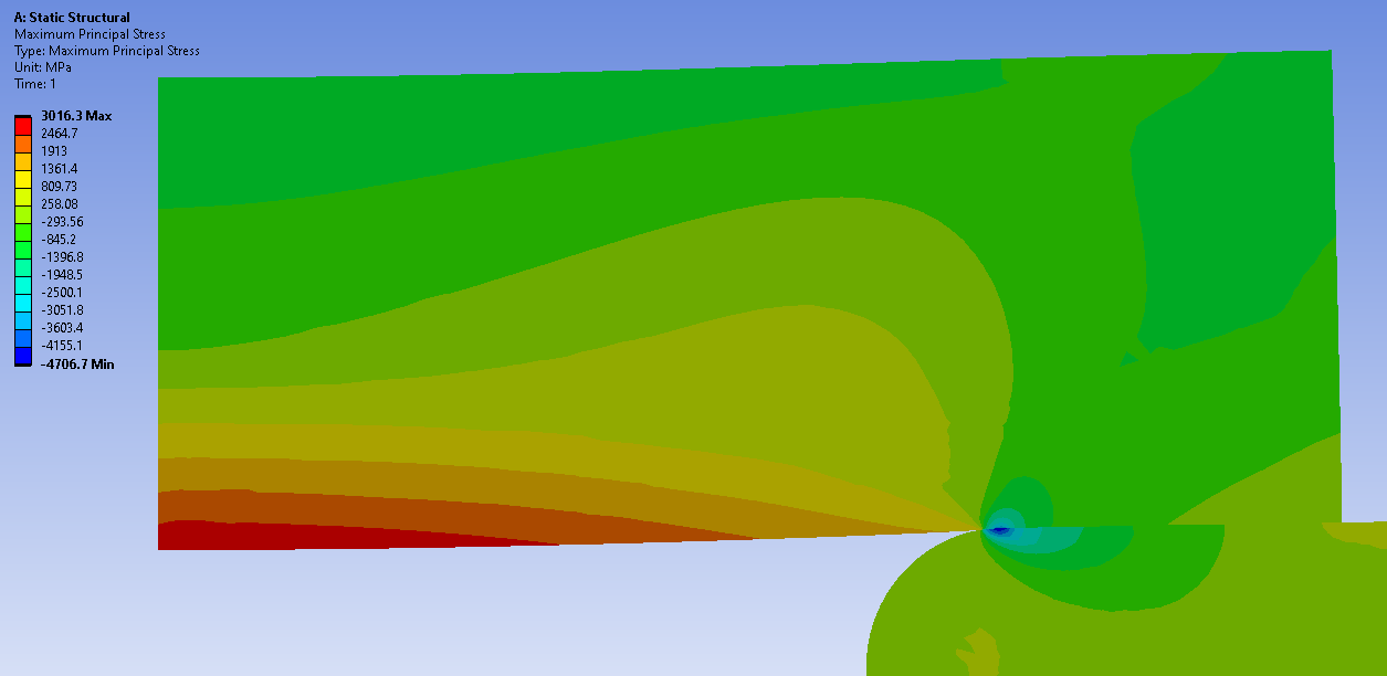

SubscriberHi Henrique,
Attached is an Axisymmetric model of the diamond window on a steel shoulder subject to 1 GP of pressure on the top and side, using linear materials.
The compressive stress is around 7.7 GPa. Some of the stronger grades of steel have tensile strengths up in this range, but many are lower so you will have to select the steel carefully.
The tensile stress in the window is about 3 GP. You didn’t say what the ultimate tensile strength of diamond was.

I have a few questions about the setup and results:
- Why the displacement X=0 was set on the window edge? I mean, shouldn't the Axisymmetric condition already guarantee that? Would it be correct to set X=0 for the vertical edge of the metal shoulder?
- Why did you activated the Large Deformations option?
- I realized that I do not understand the concept of Principal Stresses.. I thought that they were stresses on the direction of a plane in which no shear occurs. Why then do you say the Maximum Principal Stress is the tensile and the Minimum is the compression? I'm having trouble to interpret these results..
- When looking at Minimum Principle, we can note a "mirrored" stress distribution in the interface between materials. How can I interpret these?
- Would it make sense to use the Normal Stress results in Y direction as the variable of interest? Or even the equivalent stress?

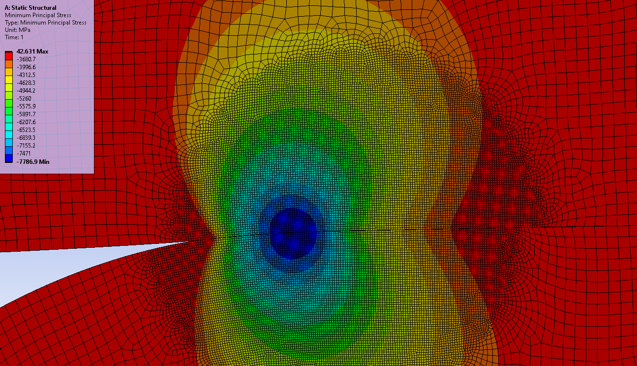

Subscriber- The displacement BC on the axis is not necessary, but it doesn’t hurt. If the pressure from the window caused the steel ring to squash down and the sides were to change shape slightly, you wouldn’t want any BC on the sides so it was free to do that.
- Large Deformation was used to update the nodal locations so the frictional contact could update the pressure being transferred and keep the contact pressure as accurate as possible.
- Maximum Principal Stress = the highest tensile stress and Minimum Principal Stress = highest compressive stress. You can find more information in a Solid Mechanics course.
- The mirrored appearance of the Minimum Principal Stress is because there is a small zone of contact on the rounded edge of the steel ring due the the diamond window bending slightly. The stiffness of the steel and diamond are similar so the stress pattern is similar.
- Equivalent stress is only positive and is used to evaluate the stress in ductile materials that might be approaching the yield point. Diamond doesn’t yield, it fractures and comparing the Maximum Principal Stress with the Ultimate Tensile Strength of diamond is one way to decide if the window will fracture.

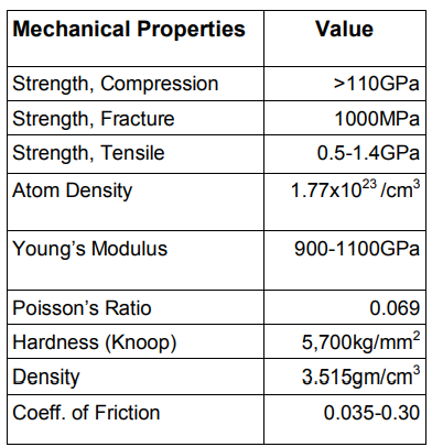

The diamond window manufacturer provided the following material properties:
The tensile strength range is quite large, so this is something I still need to clarify with them. But what I do not understand is the Fracture Strength. Do you know what this property means, and how it is compared to the tensile strength? I did try to do some research on it, but couldn’t find an easy and direct answer.
Cheers,
HenriqueÂ
February 9, 2023 at 6:22 pm
peteroznewman
SubscriberI expect the Tensile Strength has a range due to various depths of flaws on the surface. A flaw could be a scratch on the surface or an imperfection in the single crystal structure. A surface with a shallow flaw has higher strength than a surface with a deep flaw.
Another way to decide if a given load is at risk of fracture is to assume a particular flaw depth on the surface and use that to calculate a Fracture Mechanics solution. Read the chapters on that in Help.
You need to compare the Stress Intensity Factor K(1) calculated from the flaw size and the nominal stress with the Fracture Toughness K(1c), a material property.
Here is a paper on the Fracture Toughness of Diamond.
I don’t know what Strength, Fracture = 1000 MPa means in the table of properties.
