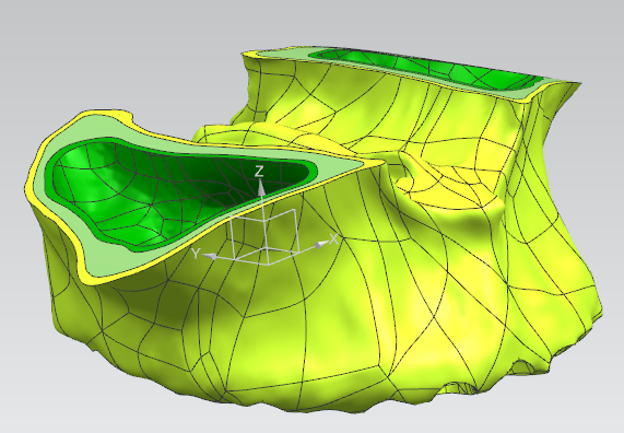

SubscriberHi,
I need to constrain an assembly to prevent any rigid body motion. It consists of the bodies highlighted in different colours. Other bodies not displayed in the picture are in contact with the yellow body on the inferior side. I want to apply a fixed support to this assembly. The idea is to scope the top faces of the displayed bodies, but would it be sufficient to prevent any motion? Should I scope the whole bodies instead?
December 15, 2020 at 12:42 pmRahul Kumbhar
Ansys EmployeeIf you apply 'Fixed support'on the faces, it should be sufficient to stop rigid body motion. But depending upon the loads and material properties, if the material deforms a lot, then it can give element distortion.nDecember 15, 2020 at 1:25 pmm.caragiuli
Subscriberok thanks. By applying the fixed support on the entire bodies will it be an overconstraint?nDecember 16, 2020 at 3:52 pmRahul Kumbhar
Ansys EmployeeI am not sure. It depends upon your boundary condition. Sorry if my previous reply created confusion. I meant if you just select one face for fixed support, that should be sufficient.nDecember 17, 2020 at 4:13 pmm.caragiuli
SubscriberPlease note that the depicted bodies are flexible and a shared topology has been used to create a conformal mesh, thus they are bonded together. However, I think I should constrain the top surface of each of them, not just one, despite the present bond. Am I wrong?nMany thanks for your reply. nDecember 18, 2020 at 8:30 amRahul Kumbhar
Ansys Employeeyes, you should select top surface of each of themnDecember 18, 2020 at 1:58 pmm.caragiuli
