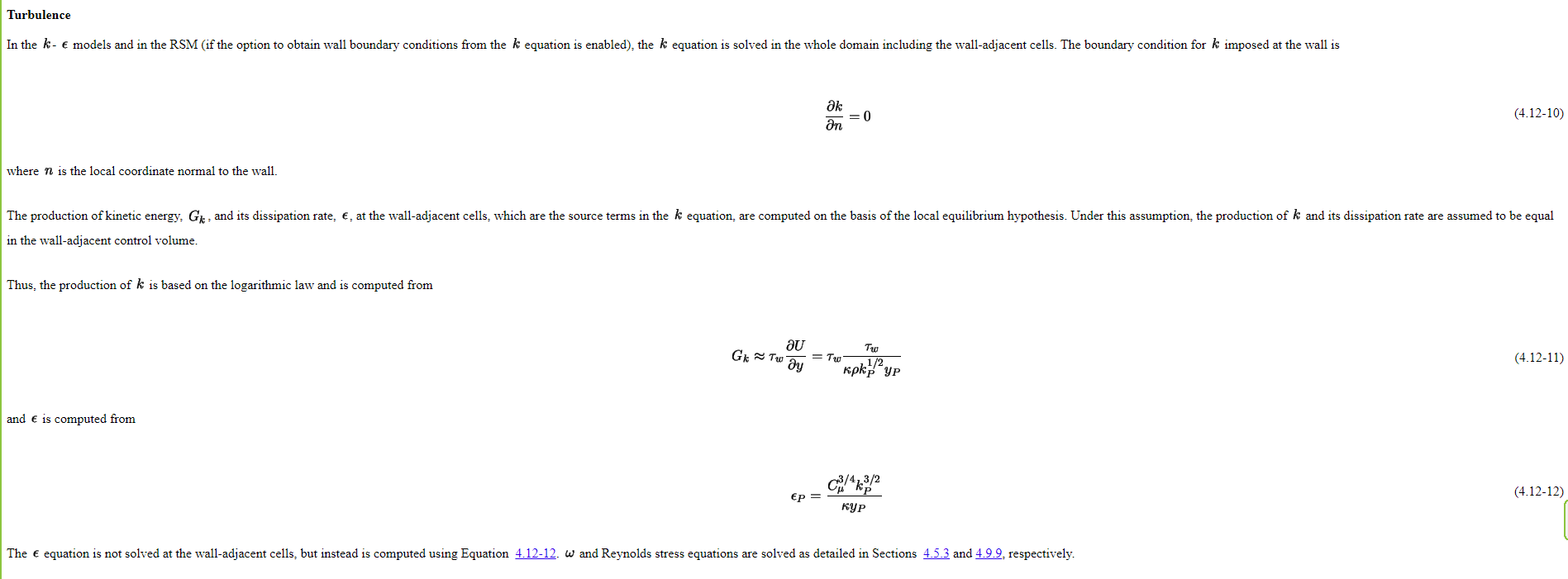

      For Wall function approach the k and epsilon equations are not solved upto the wall, rather their value is pescribed at the first cell centre adjucent to the wall boundary. Ansys Fluent theory guide tells this is how the values of k and epsilon are solved in the first cell centre.
      I want to customize these values as per my requirements. Please inform how to pescribed the customized values of the epsilon at the first cell centre.
      No where the same is discussed with clarity .

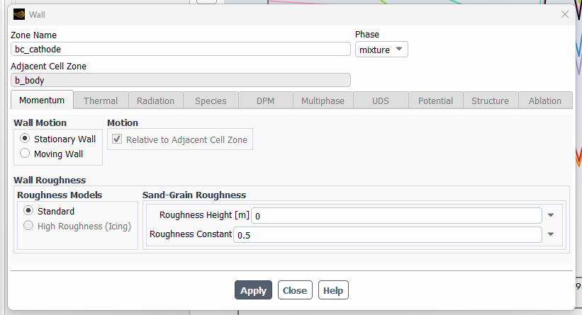

      Thanks, Now I have sucessfully able to separate the first layer cell using cell register. I think now I can able to provide the modified value of epsilon in this layer of cell using fixed values. In Two scale approach, I too need to provide the Neumann boundary for k at the wall boundary. How to provide the same ?
    • Essence
      This might be useful.
